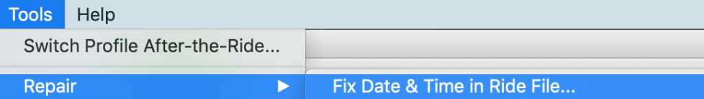

1. How would Isaac know the date/time is wrong, before the user says it is wrong?
2. It is not a simple thing to change the PH app to transmit date/time.
If the date/time in a ride file is wrong, you can use the command below to fix the date/time. (You don't have to have the exact date/time in the correction).
Screen Shot 2019-04-28 at 1.40.40 PM.png (166.75 KiB) Viewed 5034 times
Then, re-sync your GPS data. It should work just fine.
