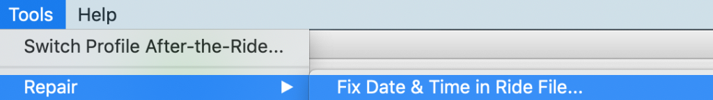

1. How would Isaac know the date/time is wrong, before the user says it is wrong?
2. It is not a simple thing to change the PH app to transmit date/time.
If the date/time in a ride file is wrong, you can use the command below to fix the date/time. (You don't have to have the exact date/time in the correction).
Screen Shot 2019-04-28 at 1.40.40 PM.png (166.75 KiB) Viewed 5032 times
Then, re-sync your GPS data. It should work just fine.

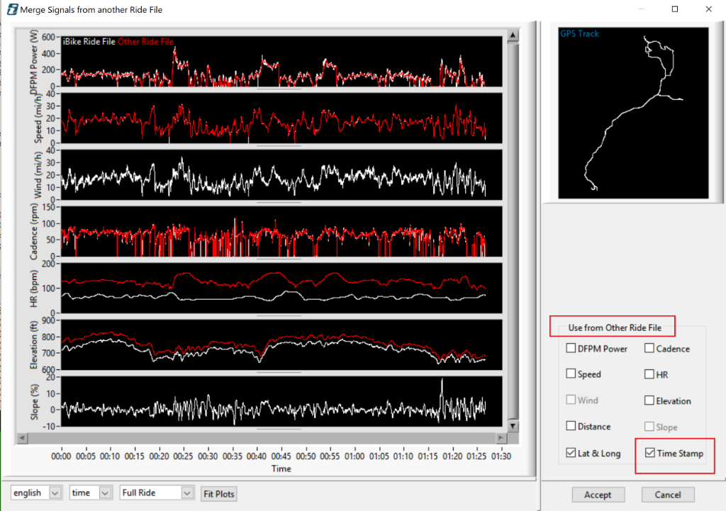

It seems to me that if Isaac offers to use the date/time from the GPS data that it should use it even if I have not gone through the process you outlined.
As best I can tell checking that box has zero effect:

Personally, I've never used that checkbox. My process is:
1) I update the date/time of the ride file
2) I then merge with GPS data
It seems the reason you are getting messed-up date/time is because you're resetting the unit in the field. I believe this is happening because you report odd behavior when pairing/calibrating while in motion, which you correct by a hard reset.
Pairing is normally done while the bike is not moving. I have never had a problem when I pair the sensors at rest. This might be the easiest way to solve your problem.

Similarly I thought that you should be aware that the checkbox in the merge dialog is non-functional, whether or not you use it. SOMEBODY obviously thought that it was important enough to include that in Isaac ... they just didn't do a very good job of implementing it.
