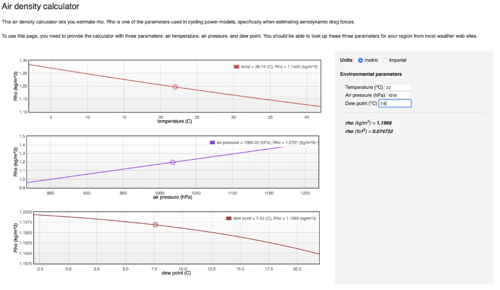

I am returning to the original posting, because I want to make sure I provide the correct information.
We measure air pressure, then use the usual conversion formula to convert the air pressure readings into wind speed.
One of the important factors used in the conversion formula is "rho". The value rho varies with temperature, elevation (barometric pressure), and humidity.
In our devices we adjust the value of rho in accordance with changes in barometric pressure and temperature. We don't adjust rho for relative humidity (RH).
In our view, humidity correction is minor. The graph below, from here https://www.gribble.org/cycling/air_density.html illustrates this.
The maximum variation, due to RH, at sea level (where the RH effect is greatest), going from 0% RH to 100%RH is 0.8%.
For typical day to day rides here in Florida, the RH variation might be from 50% to 80% (at 22C, roughly dew point of 7.5C to 10C). The effect on rho of this change in RH is 0.07%.
The effect of RH on rho is less at higher altitudes.
Screen Shot 2019-04-27 at 10.13.49 AM.png (177.06 KiB) Viewed 8062 times
BillOsler
Posts: 116
Joined: Mon Apr 04, 2016 10:10 am
Re: Air density estimates
Post by BillOsler »
Thank you for the detailed response. That makes sense.
I'm not sure that the air density (rho) reported by Isaac in the exported CSV files matches well with the temperature and pressure values reported for the ride file but the differences are small.
