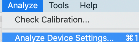

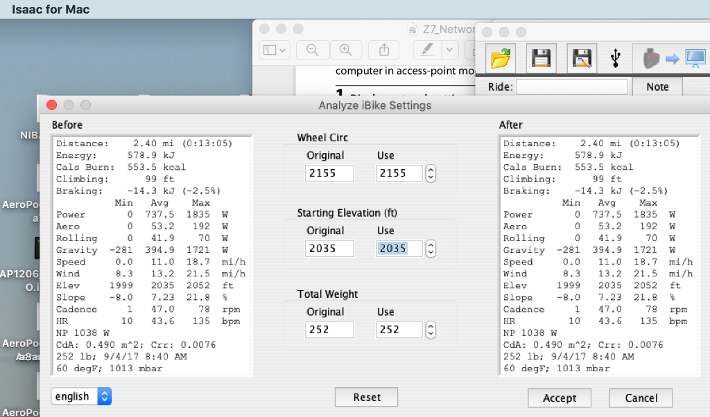

After the ride, you can change the starting elevation in Isaac using the command shown.
What's going on is that the absolute barometric pressure, which is measured by AP, changes according to weather.
