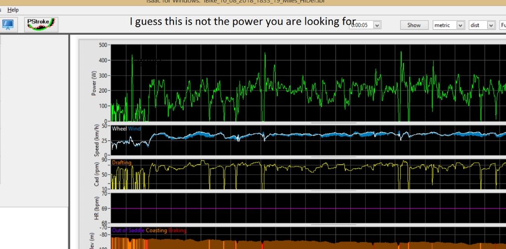

Re: Aeropod config 50w and ???
Hmm...in the ride file you posted, there is no DFPM data. I looked in the excel file as well.
If you see data please post a screen shot from Isaac. Make sure you check the "View DFPM" box.
Screen attached - so the power here is the AP? - figures were high as this was my TT run on this course for the month and basically found another 80 watts although first 20k is basically a slow uphill drag
Reading more is the HR channel where the dfPM is expected
OK we are off for a ride - hopeful of some data - full reset
- 3dp-screen.jpg (103.13 KiB) Viewed 6488 times

In the past it would wake up on just a couple
of spins on the crank by hand - now you need to ride it
However the power curves seem pretty similar
I will be out tomorrow hopefully with a cleaned profile and see if I can tell the difference on helmets plus get a more optimal cda from the start
Call this a case closed
Agreed the Rotor is a prime suspect since I change batteries (previously Duracell which I can't easily get in UAE)
