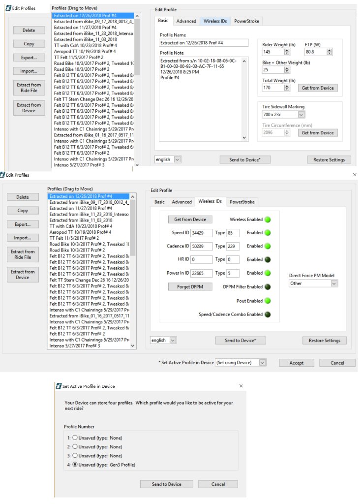

I grabbed several screen shots. I'm not sure why the Set Active Profile dialog says Profile 4 is "Unsaved" but if I am interpreting the screen correctly it confirms that I have not set up Profiles 1-3. In any event at the beginning of the ride in question I confirmed with Powerhouse that the Aeropod was set for Profile 4.
The other dialogs show the profile I was using for the data collection.
The key finding, which I confirmed this evening, is that NONE of the wireless IDs listed in the profile correspond to the bike I was riding. ALL of them correspond to a different bike that previously was paired with the Aeropod. That bike was hanging untouched on a rack in the garage, nowhere near where I was riding. Since the DFPM wireless ID and cadence ID were for a different bike it makes sense that the Aeropod did not record anything on those data channels ... but how the bike recorded information from a speed sensor that was turned off and attached to a different bike is a mystery to me. The bike I was riding was previously paired with the Aeropod which makes me wonder ... is it possible the Aeropod "remembers" the speed sensor from previous pairings? That's basically what my Garmin does, it recognizes any previously paired sensor regardless of which bike the sensor is/was on but with the Garmin that behavior is "by design".

Hmm...I would look at your other profiles and confirm that none of them have any wireless ID information stored in them.
It is odd to me that AP worked with the "wrong" speed sensor ID. Your calibration data looks great, so most definitely the profile that was being used was set for the bike you were riding.

At the risk of seeming obtuse ... how do I confirm that there is nothing in Profiles 1-3?
That's what I was trying to do when I took the screen shot of the Set Active Profile dialog box.

Re: Failure to record data
Thanks for the clarification.
For Profile 1-3 all of the Wireless ID tabs were identical. All IDs were 0, all of the sensor "buttons" were black (or is it dark green?) except the Pout Enabled button was a bright green.
There was no sign of any wireless ID associated with the bike I was riding.
