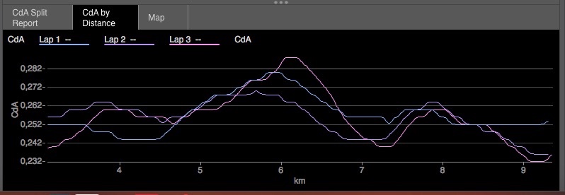

Just a quick follow-up, I rode a few laps on a different course today.
First of all, I'm impressed with the overall consistency of the CdA estimates across the laps. As you can see, the three laps resulted in CdA values of 0.258, 0.256 and 0.257, even though I had to coast a little on the third lap because of a truck (these laps where done in a quiet industrial zone, but one truck had to leave saturday morning). I did not press the lap-button during the laps, to avoid the artefact of CdA-reset.
Also, the estimated power numbers are very, very close to the DFPM numbers; on average less than 1 watt difference. Again, impressive.
However, I see the same pattern re. headwind and tailwind on this course as on the other one. I've attached the ibr-file.

Re: CdA changes between headwind and tailwind - to be expected?
Another view; the pattern is fairly consistent across the three laps. Noticeably, near the end of lap one, CdA is is unchanged for more than 1 km / almost 2 minutes.
The two sharp corners at the west end of your route may also be a contributing factor to the CdA "bump"; the corners are only 1 minute apart.
Otherwise, I agree this is really solid data!
Thank you. Yes, the corners may have an impact, but the overall tendency remains. CdA climbs with tailwind, falls with headwind. It would be interesting to see CdA-numbers without smoothing, to see how abrubt the change really is. Please, make CdA smoothing configurable, like smoothing of power numbers is
"Noticeably, near the end of lap one, CdA is unchanged for more than 1 km / almost 2 minutes." I think this is worth looking into, a completely steady CdA for almost 2 minutes seems unrealistic.
I will try a different course as soon as weather permits. Winter is closing in over here, so it isn't getting easier to find useable conditions, unfortunately.

On the headwind/tailwind issue just wondering: Since many of us have switched to winter tyres with higher Crr, wouldn't this give apparantly higher CdA, but more too high in tailwind and less too high in headwind?
This is a surprisingly tricky question!
Crr determines the number of watts produced by frictional rolling resistance. Watts caused by frictional Crr are proportional to speed; for example, (and this is made up), if frictional watts are 10W at 10 mph, they would be 20W at 20 mph.
Note that the value of frictional watts calculated by AeroPod is dependent on the value of Crr selected by the user.
Let's suppose your winter tires have higher Crr, but you don't adjust AeroPod profile settings to account for the higher Crr. And let's suppose the increase in Crr is high enough such that it can be noticed. And finally, let's suppose everything else on your bike ride is the same (bike speed, wind speed, slope, acceleration). Here is what will happen:
1) With winter tires, to hold the same bike speed you will have to pedal a bit harder, in order to overcome the increased frictional forces. The DFPM will measure slightly higher applied watts, because Crr has increased.
2) AeroPod will NOT measure higher opposing frictional watts, because it's internal Crr setting is the same--from your summer tires.
3) So, AeroPod watts reading will be slightly lower than the DFPM reading. AeroPod will therefore INCREASE measured CdA by an amount sufficient to account for the higher watts reading reported by the DFPM. So, the effect of higher Crr on CdA is that CdA value goes up a bit. And I mean--just a small amount. Why? Because the opposing force of wind is MUCH greater than the opposing force of friction. Therefore, the impact of changes in friction, say from summer to winter tires, have a relatively small impact on total opposing force, relative to the impact of wind.
All of the above is why we say, multiple times in the instructions, that we assume Crr is constant, and that you should do CdA testing on roads where the pavement is not changing!
OK, now to the next question: what effect would headwind/tailwind have on the "Crr effect" of winter tires?
The answer is, not much. Why? It's for the same reason as above: wind forces are much greater than frictional forces. Headwinds and tail winds will affect bike speed (assuming you're holding the same level of power). With headwinds, slower bike speeds--but only slower enough to overcome the even stronger force effect of wind. Frictional force will go down a bit in a headwind (slower bike speed), but the reduction in frictional force, which varies linearly with bike speed, will be overwhelmed by the increase in wind force, which varies as the square of bike speed.
John,
Thank you for good explanation. Just to add to the argument, in a tail wind, the speed will go up, frictional forces will go up but wind resistance is smaller. Thus, could errors in Crr estimation create the difference between head and tail winds? In principle there should be no difference, right?
Also, why wouldn't the most accurate CdA measurement happen on steep downhills? The power meter would read zero (no inaccuracy) and it is all down to accuracy of wind measurement and slope measurement (both under Aeropod control). Also, the higher speeds of downhill would create very large wind resistance making wind force much bigger than friction force.
Morten
Morten
