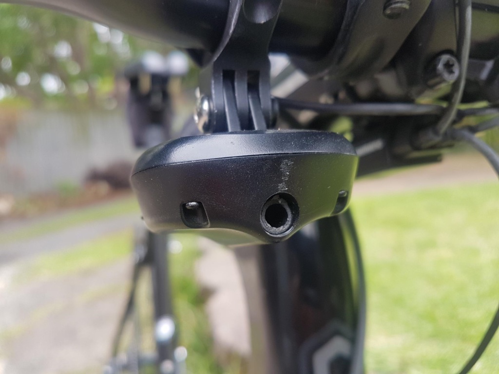

Having used my Aeropod over the last 6 weeks to tune my bike fit, clothing and equipment choice, I was excited about seeing how aero I could be during the race. But unfortunately, the thin tube on the front of my aeropod snapped off as I placed my bike bike on the racks in the bike transition area before the race.
This created 2 problems. Firstly, I wasn't confident how accurate the Aeropod would be without the thin tube attached (so I ended up not using the Aeropod during the race and relied on my DFPM instead). Anyone have any experience or guidance on the accuracy without the tube attached?
Secondly, despite finding the broken piece of tube on the ground, I can't easily re-attach it. As you can see in the attached pictures, the threaded part of the tube is stuck inside the Aeropod body. I could perhaps simply glue the broken piece back into the hole, but then obviously it will be permanently attached to the Aeropod itself, which isn't ideal.

You should be able to remove the screw portion of the pitot tube that is stuck inside your AP. You'll need to insert something into the interior of the tube--perhaps a thin pair of needle-nose pliers, then rotate the pliers counterclockwise to get it out.
It's too bad you did not use your AP during the race--we could have manually adjusted the file afterwards
Once you get your tube out please email tgore@velocomp.com. Tom will get you a replacement pitot tube.

Good idea, I've managed to get the broken piece out with a screwdriver.
Will email Tom as suggested to get a replacement. Thanks John.
