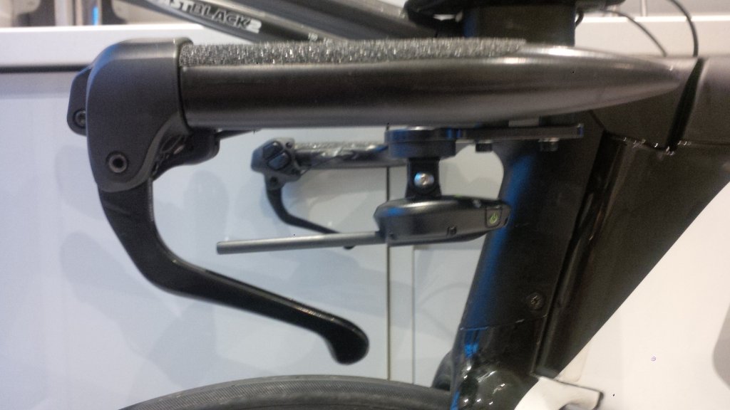

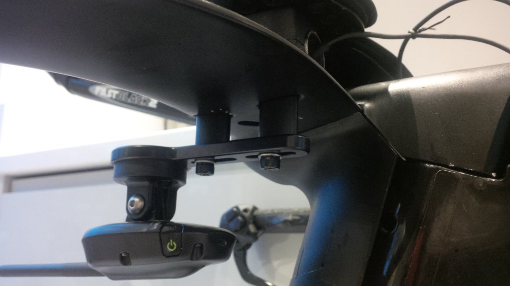

can you confirm I am using the right "Device Mount Location" as Front Mount with the supplied TT bike mount in Device Setup?

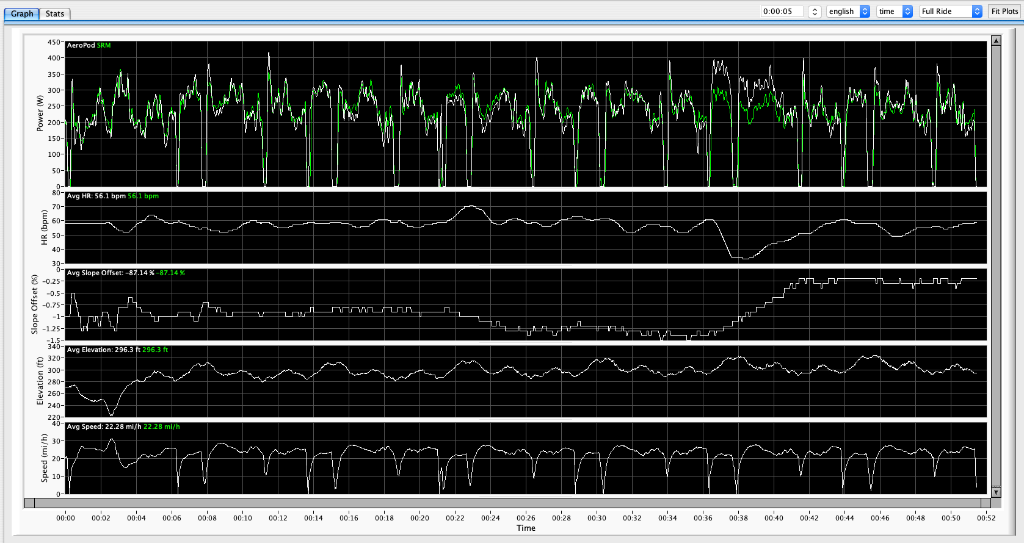

I think the route a good one.
Your calibration ride is fine.
At minute 42 you bumped the AeroPod and rotated it to a different position. It took a few minutes for it to readjust.
Mount location in Device Setup is irrelevant; AeroPod will automatically recalibrate itself based on the actual position of the device on your bike.
One important thing: there are sections in the ride where you have zero cadence, and therefore zero power. In looking at your .zip file, the SAME zero cadence and power shows up. So, both your Garmin and your AeroPod were seeing the same data. This means your SRM was not transmitting power and cadence in those sections. You might want to check to be sure your SRM is working properly.
I agree that doing testing on a calmer day would be a good idea. You can see differences in measurements between the "out" portion of the ride and the "back" portion. With calmer winds this should be minimized.

Re: My First Ride with AeroPod
I did another test this Sunday, same road but the wind was a bit calmer than the first time. the first time I had a 10.7mph cross wind from NNE direction, this time the wind was still a cross wind from a different direction,with a speed of 7.5mph, from the south. I did a hard reset as suggested and sent the seupt file again to the device. The pairing and cal ride was carried out without issue.
I tried different helmets again,
I wore the Kask Bambino with the visor clipped up for the cal ride and upto 2.4 miles into the ride
I then used it again with the visor in place upto 5.1 miles
I then changed to the Giro Selector upto 8 miles
I then changed to a Std Road helmet with multiply vents upto 10.7 miles
I then changed to the Rudy projects upto 13.5 miles
I the went back to the Kask (visor down) upto 16.3 miles - this run showed a really low CdA on the Garmin down to 0.145!
I repeated the run as the values seen did not seem correct
A total of 19.1 miles in the second recorded file on the AeroPod for the day
I am getting more familiar with the Isaac software to analyse the results but I am not seeing the repeatability of CdA values I was hoping to see.
The CdA value changes quite considerably during the ride without me changing my position at all. There is also an anomaly with the slope data between 13.5 miles to just after 15 miles giving a false CdA value I believe. I did not knock the AeroPod or any thing like that, only difference was the time to change helmets as I was chatting to a friend who came by, but a couple of minutes only. Although it was a calmer day there still was a significant cross wind, Is this having an adverse effect on my data? You can see a difference from the aero helmets to the std road helmet but I do not feel the results between the aero helmets is valid enough to make an informed decision which is best for me. The first and last run with the Kask (visor down) do give the same average CdA value for the complete run but different in different section in the same direction.
1) You can merge your GPS data into the AeroPod ride file using the command "File/Merge GPS Data..." After you do this, if you save the ride file then the map information will be saved too. I attach the merged ride
2) Wind data looks much better
3) Something knocked your AeroPod out of position at minute 22 (mile 8), and later again at minute 36 ½ (mile 13.5). I can see these changes in the internal "slope offset" adjustment. Whenever AeroPod is moved, it takes 5 minutes for the slope correction to work. So, your data from minute 22 to minute 27 is invalid, and from minute 36 to minute 42. Make sure that your AP is rock-solid tight on its mount.
Also: please post a photo of how you have AP mounted to your bike.
- Graham_11_04_2018_1111_19_Miles_HiDef.ibr
- (559.46 KiB) Downloaded 402 times
- Screen Shot 2018-11-06 at 8.59.52 AM.png (117.58 KiB) Viewed 12011 times
AeroPod is mounted using the supplied TT mount to a Giant Trinity base bar as per instructions and is firmly mounted. It did not come loose during the ride or get knocked. I did not ride over any pot holes, the tarmac surface does have small imperfections but nothing you would not expect to see on a maintained public road. I can get a picture of it later tonight when I get home and post it for you to look at.
Is there anything else that could be at issue?
I am aware of the "merge GPS data" and have done that but its still not as precise as defined GPS points to select segments.
Please do not feel that I am unhappy with AeroPod's performance and I realise that in field CdA measurement can be fickle at times I just want to get it as precise as possible to find the the marginal gains in my setup
Graham
Hi Graham:
I do not take your comments in any way negatively...
SOMETHING is causing AeroPod angular position to change; of that I am 100% certain. Once I see your photos I might be able to make some educated guesses.

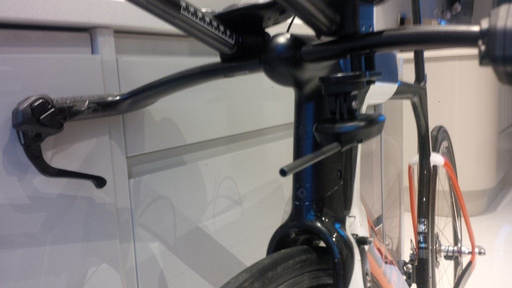

Pictures Attached
- IMG_20181107_072343.jpg (71.29 KiB) Viewed 11982 times
2
- IMG_20181107_072510.jpg (70.15 KiB) Viewed 11982 times
Assuming your extension posts above the TT mount are stiff, your setup looks really good!
Make sure your mount has no wiggle and that the AP bolt is really tight, so there is no possibility for AP to rotate. Do another ride when possible, then post the ride...
