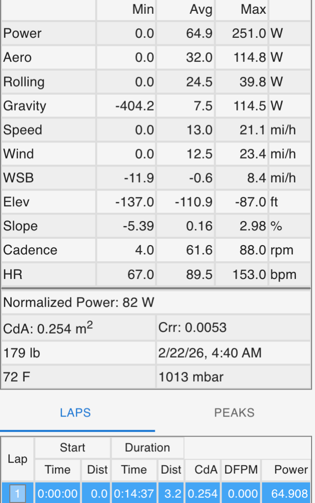

Re: AP new calbration - new garmin connect app
new file attached. Can you check it...i think you can tweak the setup a little.
By the way, i still cant use the newton tracker... maybe there is a new APK file but i cant find it.

- Velocomp_22_02_2026_0640_93_km.ibr
- (1.18 MiB) Downloaded 18 times

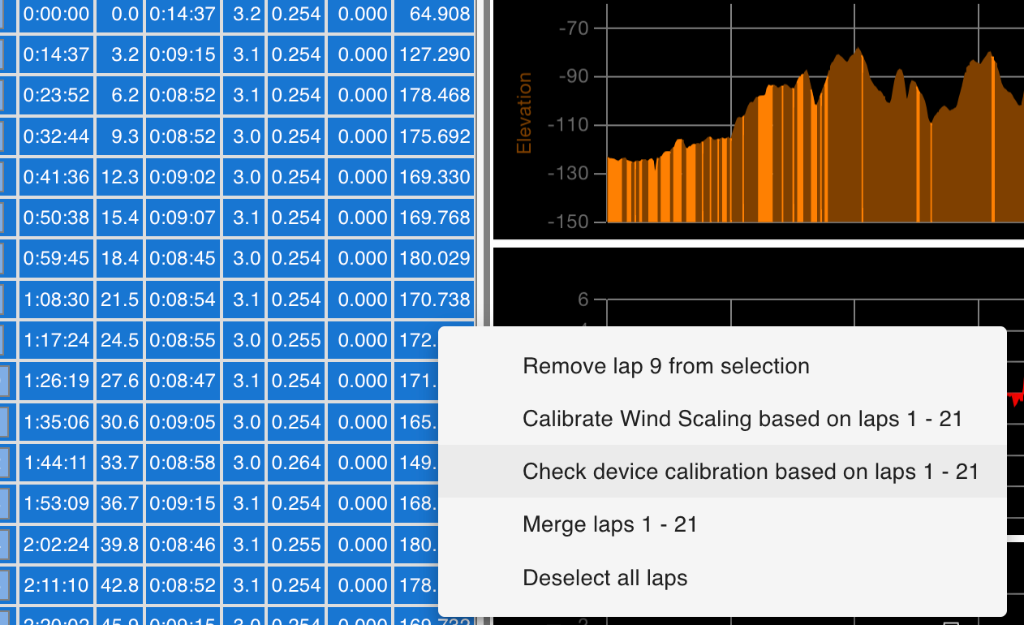

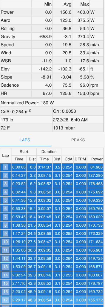

Here's how to tweak things:
1) You are doing closed loop laps, so adjusting your wind factor is acceptable. If the file isn't for closed loops, then adjustment is risky

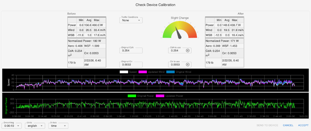

2) Your unadjusted file shows watts of 156.6. and a wind scaling balance of 1.0--this means your wind readings are slightly high, leading to higher watts
3) Click on lap 1. It will then be highlighted 4) Hold the shift key and then click on lap 21. All 21 laps will be highlighted
5) Right click and select "Check Device Calibration based on laps 1-21
6) On the next screen you'll see the corrected profile. WSB is 0.0 (as it should be) and watts are reduced slightly to 148.6W. Click Accept to implement these changes
1) Connect your PP to VA
2) Do the procedure above to correct your wind scaling
3) After correcting the ride file, go to Edit/Edit Profiles/Extract from Ride file. This will transfer the corrected profile into VA
4) The corrected profile will be highlighted. Use the command "Send to Device" to transfer the corrected profile to your PP
No update on Newton Tracker/Android; however, note that you can get GPS info from your Garmin into VA
