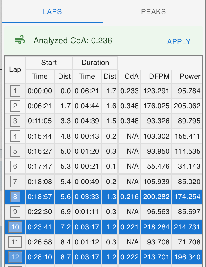

Attaching two files, thanks John
Context:
Test-A: Baseline
Test-B: 6cm higher stack compared to Test-A
Test-C: Same as Test-A but with aero baselayer, different skinsuit, and calf sleeves
(File 1 - 27 miles)
- Laps 4, 6, 8, 10, 12 - Test-A
- Laps 14, 16, 18, 20 - Test-B
<Downloaded ride file to laptop, w/o removing aeropod>
(File 2 - 11 miles)
- Laps 2, 4, 6 - Test-A
- Laps 8, 10 - Test-C
FWIW, I've noticed two inconsistencies in the VA graphs wrt the turn-around point:
1. On some laps it does not detect/report "Braking" (in the Elevation row)
2. The slope it reports around that point is inconsistent in both, magnitude and direction
I've noticed this across a bunch of different tests, and I'm not sure if this is affecting my results

Hi John
I did some more digging into the data and found something interesting. At first I noticed that the CdA values reported in the table were more consistent than the corresponding Analyzed CdA values. Then I took a step further and split each lap into two sections - (1) from the start to just before the turn around, and (2) from a few seconds after the turn around to the end. I used the corresponding CdA values (from the table) for both sections and computed a weighted average (weighed by distance, which I got from the csv file for more precision). This new value generally seems to be more consistent than the analyzed value, especially when I compare the 2nd set of Test-A runs with the 1st set of Test-A runs.
These are the results I found, listed in the order in which the laps were performed. Each row has 3 CdA values - CdA from the new method, CdA from the table, Analyzed CdA
Standard Deviations
Test-A: 0.0038, 0.0029, 0.2246
Test-B: 0.0008, 0.0026, 0.0037
I also tested this on my file from a ride a couple weeks ago, and I see similar trends.
Test-A: 0.0016, 0.0052, 0.0063
Test-B: 0.0186, 0.0089, 0.0039
Test-C: 0.0034, 0.0052, 0.0033
Thoughts?

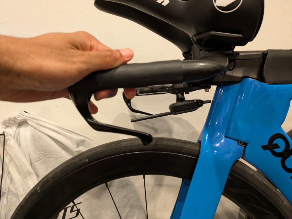

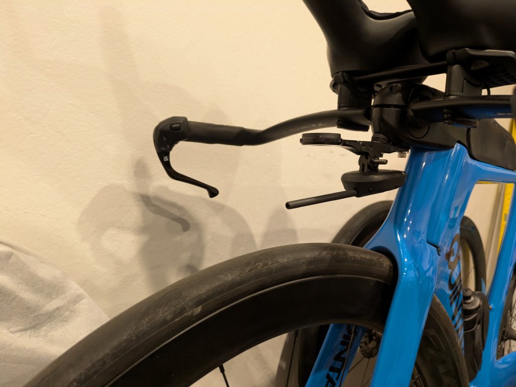

Just to make sure these factors aren't contributing to any unwanted errors, can you confirm a couple of things:
1. Is my device location and angle, as shown in the photos, fine?
2. One of my testing sites is a bike path next to a freeway. I wonder if that's causing any unwanted wind turbulence. Here's a link to the street view, do you think this location is fine? https://maps.app.goo.gl/NENMgwh5SdY5Dihn7?g_st=ac
Thank you!

Your AP is pointed down more than is recommended. I would get it eye-ball level, then lock it in to make sure it can't rotate.

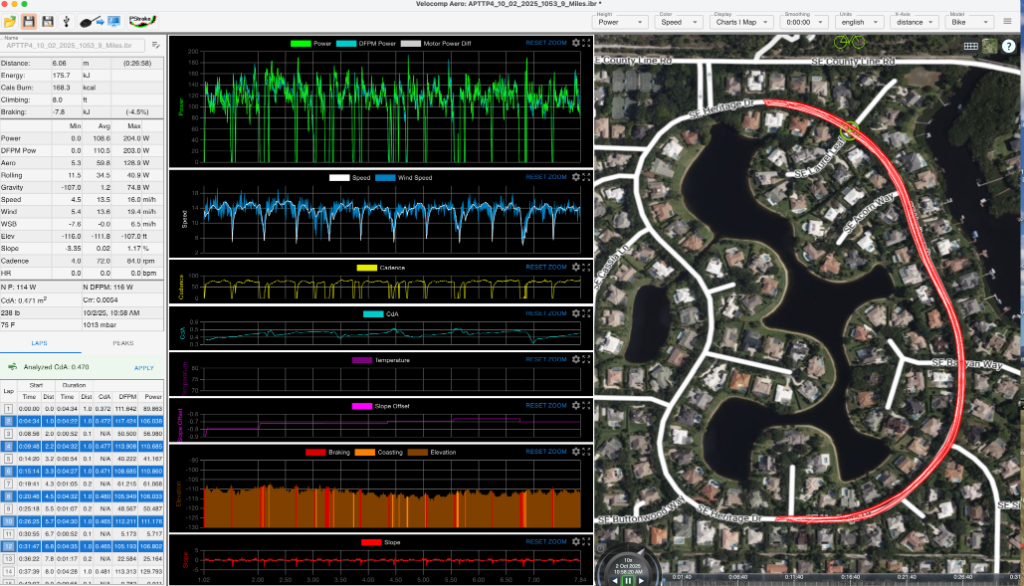

I know we're talking about this in the other thread, but I wanted to mention that I observe that effect of turn-around on the analyzed CdA on the file I shared above too.

We are taking another look at this...nikshar wrote: ↑Fri Sep 26, 2025 12:54 am I know we're talking about this in the other thread, but I wanted to mention that I observe that effect of turn-around on the analyzed CdA on the file I shared above too.

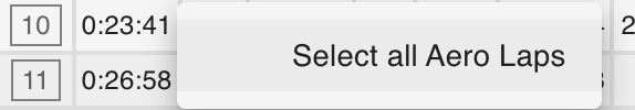

1) We just released VA version 1.026, which adds many new features for aero analysis:
A. You can select individual laps, or combination of laps, for aero analysis. Click on the "box" for each lap you want to include in the analysis. To clear the selection click "Reset" at the top right of the screen
B. Turn around laps are clearly marked with "N/A" and are not included in the calculations
C. If your complete ride file is for one configuration only, highlight a lap (don't click on it) then right click. You will see an option to "Select all Aero Laps". Selecting this will automatically find and select all aero laps for the ride file (if a lap is selected you don't want to use, click on the lap number to deselect it)

In the aero testing I do I am able to enjoy both a flat route, and relatively low ambient winds.
A recent ride file is attached. You’ll be able to see my out-and-back route, and also the “turnaround” laps between tests. Note that lap “1” was around the loop, about a 5 minute warmup. My route was only 1.3 miles long in total; not a huge amount. I did not ride at super-fast speeds or power levels, because that is not necessary for testing. You can also see I tried to maintain consistent speed/power levels while testing. Note finally that the final lap 14 occurred after a complete stop. Because this is a different protocol from my prior laps, I deselected that lap (though it has only minor effect on overall CdA).
My measured CdA is 0.470 for this set of tests; on a different day it was 0.471. (definitely not a podium-winning CdA).
