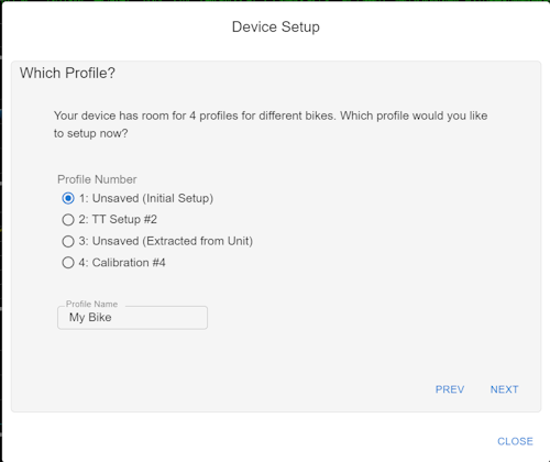

How would one select "best" calibration for the wrong profile? The Velocomp Aero PC app displays four profiles. The"Device Setup" wizard will allow "Better" and "Best" calibration modes for each of the profiles. I have "Better" selected for profiles 1-3, and confirmed that profile 4 was set to "Best" and set as the selected profile on the device using the "Configure Device" wizard.
Interestingly, when I look at the profiles in the app, it seems to have lost the settings for profiles 1 & 3 and selected the first profile?
Unfortunately, I live in a semi-urban area, there isn't anywhere around here that I can do a calibration ride. I've tried a few times/places that seemed like they might work; always run out of road before it asks me to turn around.
