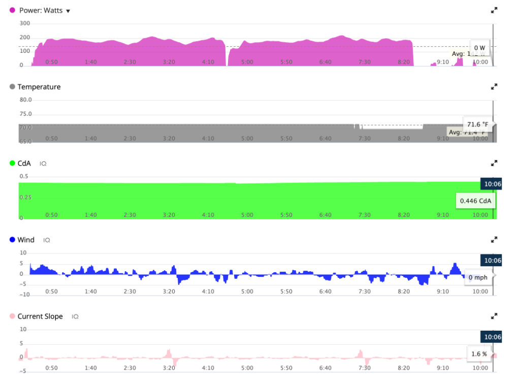

very exciting thanks for the great work. Do you know if the new data will be saved in the FIT file and shown on garmin connect in the lap data field?
Posts: 7942
Re: New AeroPod 2.0 CdA app for ConnectIQ Garmin computers
gte534j wrote: Mon Feb 27, 2023 12:40 pm very exciting thanks for the great work. Do you know if the new data will be saved in the FIT file and shown on garmin connect in the lap data field?
Yes, all the data is stored in the .FIT file and can be viewed in Garmin Connect.

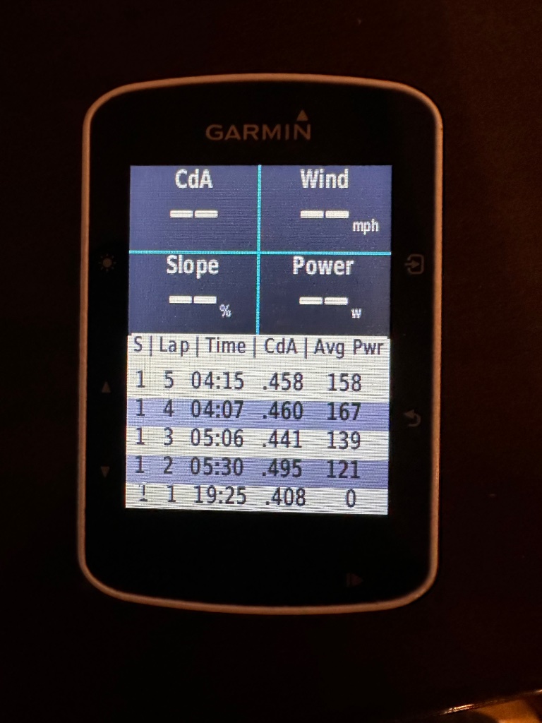

Posts: 7942
I'm not sure if that is a bug or a feature...riding after dark is not something most cyclists do :-)
Here is a shot from my Garmin this evening; I don't see any problem.

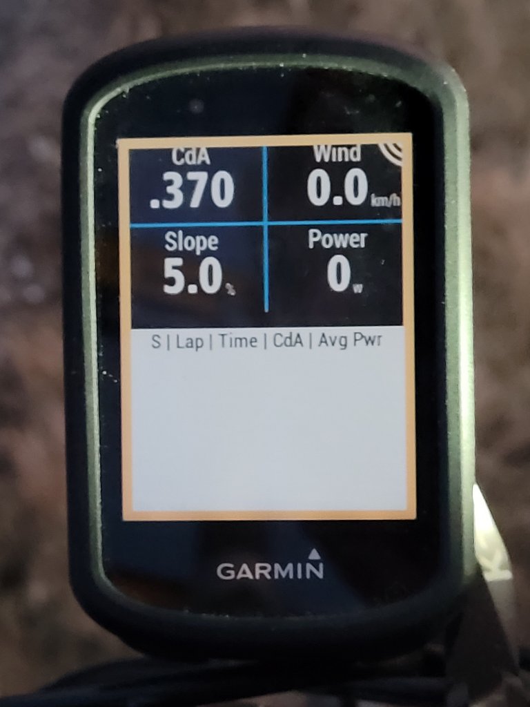

Velocomp wrote: Tue Feb 28, 2023 7:11 pm Here is a shot from my Garmin this evening; I don't see any problem.
The background colour in the lap display shoud be dark and the numbers and letters should be white so yes, your device display the same bug as mine.
Posts: 7942
mir wrote: Wed Mar 01, 2023 2:37 pm
Velocomp wrote: Tue Feb 28, 2023 7:11 pm I'm not sure if that is a bug or a feature...riding after dark is not something most cyclists do :-)
If you as I live at 55 latitude then the sun sets between 4 - 5 pm every day so riding in the dark is something required if you want to ride outside ;-)
This is fixed in the AeroPod 1.02 update we released today, March 8.

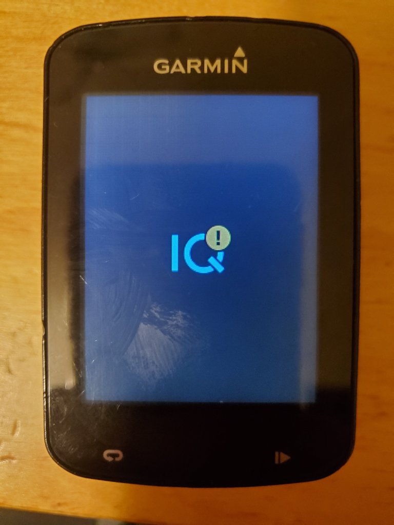

Is the AeroPod CdA app compatible with the Garmin Edge 820?
But I think it is broken in the latest version as it starts up fine and shows the display correctly
But as soon as I press the lap button it crashes the screen out.
Rather than displaying CdA information for that lap.
I've ensured that my 820 is up to date with any software updates.
Any suggestions on how to fix it or downgrade it to a version that works?
Many thanks
Posts: 7942
It should work without problem.
Uninstall AP 2.0 from your 820 and reinstall. Hopefully this will fix things.

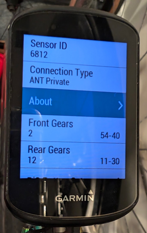

Sorry, I should have been more clear around what I meant by status, which includes the connected sensors, but also all of the other potential status options noted in the manual.
Right now I carry a printout of the PDF with me, and use it like a decoder ring to try to suss out what is going on.
mamilian.bike
Posts: 14
Joined: Mon Sep 18, 2023 10:49 am
Post by mamilian.bike »
lorduintah wrote: Tue Jul 23, 2024 12:02 pm Same for my Edge 830.
In case you do not know: from the Garmin manuals.
Thanks Tom, I am aware of this feature on Garmin head units. This would provide another path to providing the enhanced UX feature.
Maybe it could be modeled after the pattern Shimano uses for Di2
This is what is shown for an AeroPod currently.
Also, unless I'm missing something, I don't see a notification when the AeroPod indicates that it is ready to go on the Garmin. I do see a notification when the sensors connect to the Garmin, but that's not what I'm suggesting.
It would be nice if the AeroPod could report its status somewhere easy to see and decode in a bright environment.

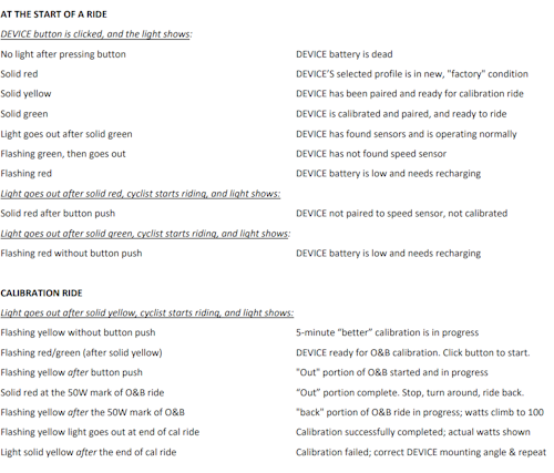

Posts: 7942
mamilian.bike wrote: Wed Jul 24, 2024 11:38 am Sorry, I should have been more clear around what I meant by status, which includes the connected sensors, but also all of the other potential status options noted in the manual.
We don't have control of the Garmin UX, so we can't add any of the indicators you are suggesting.
However, once the unit is calibrated, the only thing you need to know is this:
1) flashing green means AP is pairing. You see this when you first wake up AP
2) Solid green means AP has paired. This happens a few seconds after AP has been awakened
3) flashing red means AP battery needs charging. This can happen during the ride.

Velocomp wrote: Thu Jul 25, 2024 5:16 am We don't have control of the Garmin UX, so we can't add any of the indicators you are suggesting.
You have limited control over what is displayed on the sensor details page. Looking at the different settings available b/w different PM OEMs, this is readily apparent. For e.g., we can see that Assioma exposes settings here that AeroPod does not.
I haven't looked at the SDK in detail* to see how one might do that, or how easy it is to do that. But clearly it's possible to exercise some control over the UI here. That said, I was only raising that as another option based on Tom's comments. This wouldn't be the easiest way to get it done, and would likely require a FW update; which is obviously a more complicated thing to deploy.
My original thought was to add current status as a data field (or to the existing data field). Here, you have a great deal of control over the UX.
I have looked at the data fields SDK. As you probably know, having done it 2x, creating Garmin data fields is fairly straight forward.
* A kludgy way to do this might be to leverage unused properties of AntPlus.ProductInfo, swRevisionSupplemental for e.g.
