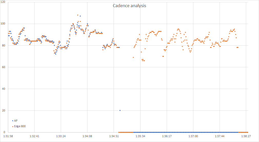

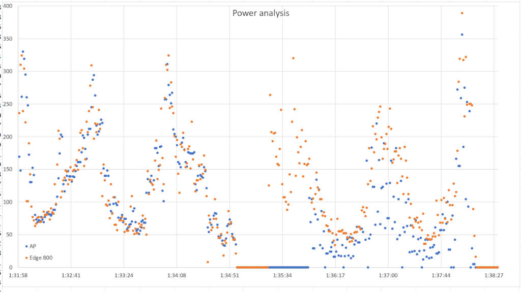

I've been getting unrealistic DFPM values in CSV exports. It seems to happen after I've coasted for a while. My DFPM is a Favero pedal based system that also reports cadence. While I'm getting the unrealistic DFPM power readings, the cadence reported by the AeroPod is zero. The attached PNG files graphically indicate the power and cadence reported by the AeroPod diverging from the actual values as recorded by a second GPS (Edge 800). Also attached is the raw CSV export from Isaac. I'd attach the activity and Excel spreadsheet of my analysis, but FIT and XLSX files aren't allowed.

I see the cadence dropout in your .ibr file. What's odd is that DFPM data did not dropout, so this means that AP was receiving non-zero cadence data.
If this continues I would do a hard-reset of AP; I have very rarely seen this problem, so this might be a one-off.
