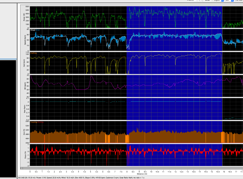

Take a look at the 6/6 ride. Wind data looks good, but perhaps a little bit low:

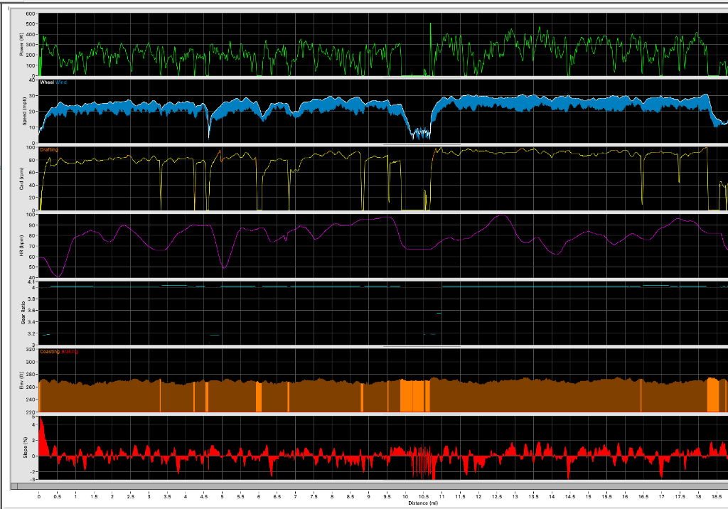

Now, look at the wind data from the 6/16 ride. Wind data looks really bad (always a tail wind):

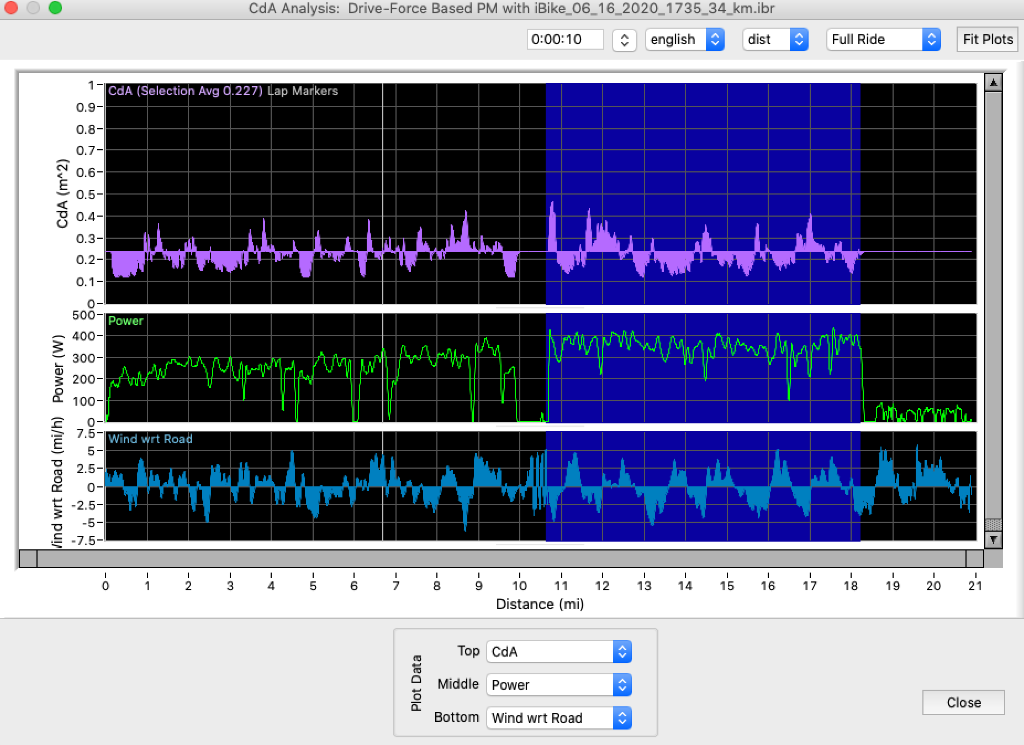

6/16 ride file with wind corrected:

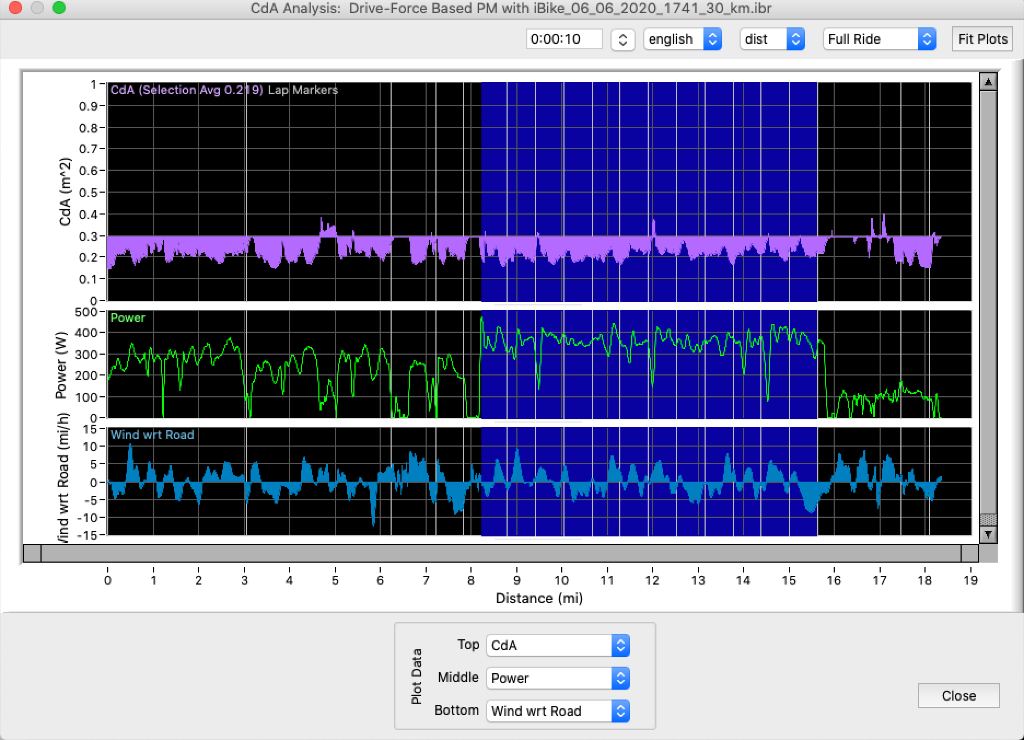

6/06 ride file with wind corrected:
2) For each wind-corrected ride file, I then used the Tools/CdA Analysis feature to determine the CdA for the test section:
6/16 ride with wind corrected
CdA = 0.227
CdA = 0.219
