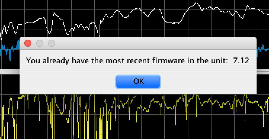

Hello,
I'm still getting "You already have the most recent firmware in the unit: 7.12"
AeroPod S/N: 12-04-18-08-06-0C-B1-00-03-00-93-03-BE-7F-20-13
Isaac for Mac: 4.1.1
Screen Shot 2020-06-01 at 8.46.21 AM.png (68.29 KiB) Viewed 6097 times
Re: New FW 714 for AeroPod and PowerPod
You need to update to Isaac 5.1 before updating to 7.14
