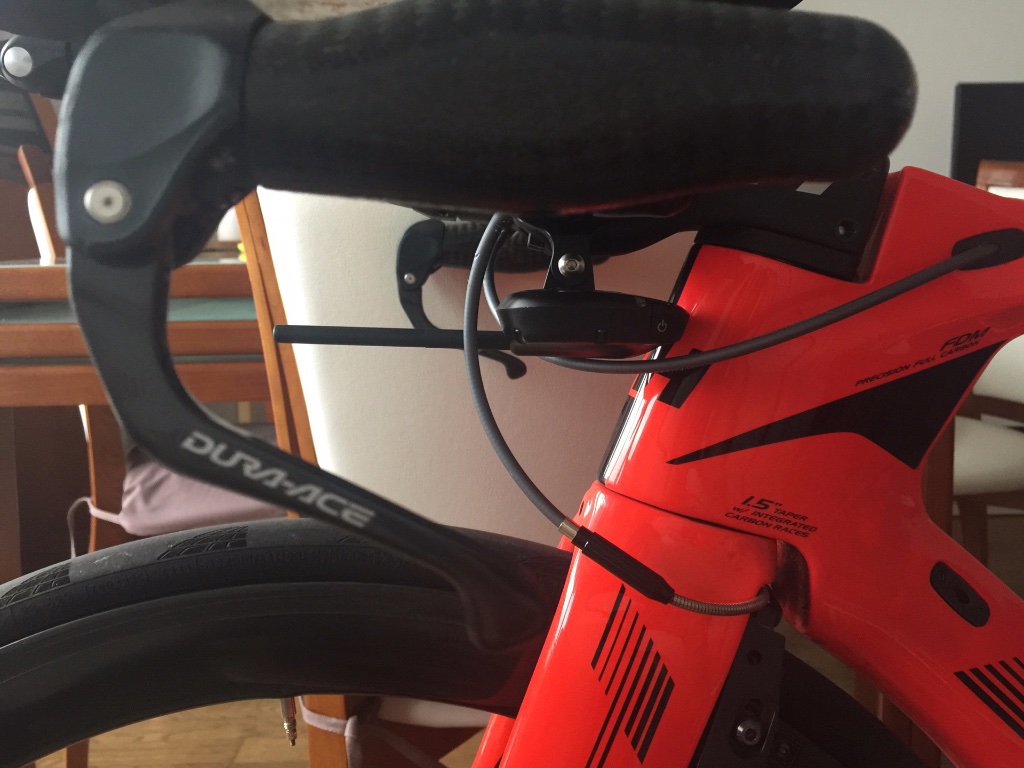

Please send images showing your front fork, and showing how AP is attached to your bike.

my aeropod fixation
Image 2.jpeg (189.19 KiB) Viewed 28132 times

Posts: 8053
Re: Use Aeropod without isaac
Your cables are touching AeroPod. I think this may be causing unstable readings.
Please move your AeroPod, or your cables so that they do not touch AP.

Posts: 8053
Yes, the location of your cables could be a real problem. It looks like one of your cables passes directly next to the baro port hole.
