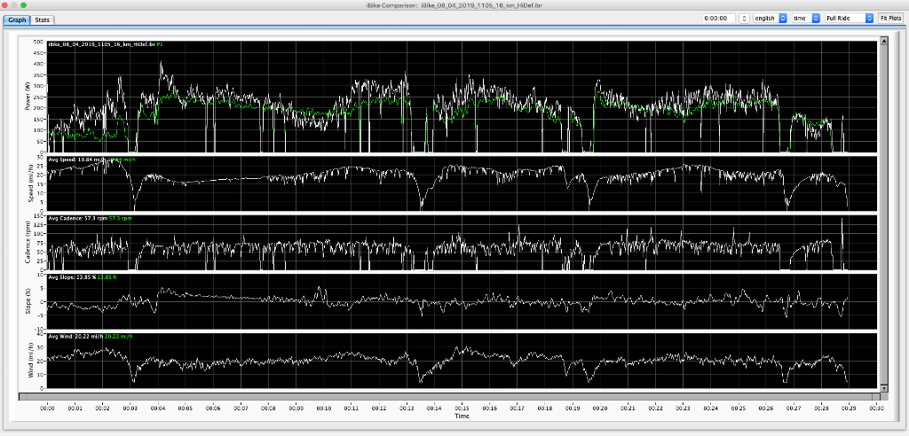

John ,here is a file but not a great one as,, i was getting live cda data after a out ad back but i think the calibration was not correct but it gave me the answer i was looking for from just after 20min till around 24 , what i did notice was that while i had AP power on Garmin cda screen and my wahoo element was connected to P1 as well to give me speed and power , even though the wahoo was reasonably stable in power the power on garmin from AP was fluctuating widly almost half of what wahoo was reading at Times hence i was asking about the P1 offset cal , the P1 offset was set by garmin when P1 was connected to garmin as power source and AP not connected and both the wahoo and garmin was reading same offset of P1,, when riding looking at both the power on wahoo and garmin it almost looked that AP was only reading one leg
i am using wahoo cadence and speed sensors , speed sensor on front wheel for a good reading , would it be better to leave wahoo cadence sensor off crank arm and just let P1 give cadence if AP picks it up ?

The good news is that the P1 is paired to your AeroPod and that its readings look normal.
That's the end of the good news...
1) Your Wahoo speed sensor is very noisy. Look at the graph: from minute 5 to 8 speed is quiet (no speed spikes) but after that...lots of speed spikes. We've seen this behavior before in Wahoo sensors; it is one reason we greatly prefer Garmin sensors. Garmin does not have this problem.
2) You'll also see that, wherever the speed signal becomes noisy, the slope and power signals are correspondingly noisy. This is the likely cause of your AP watts variation
3) The cadence signal is very noisy too.
I would replace the Wahoo speed sensor with a Garmin sensor, and I would remove the Wahoo cadence sensor from your bike. AP will use cadence data from the P1s.
