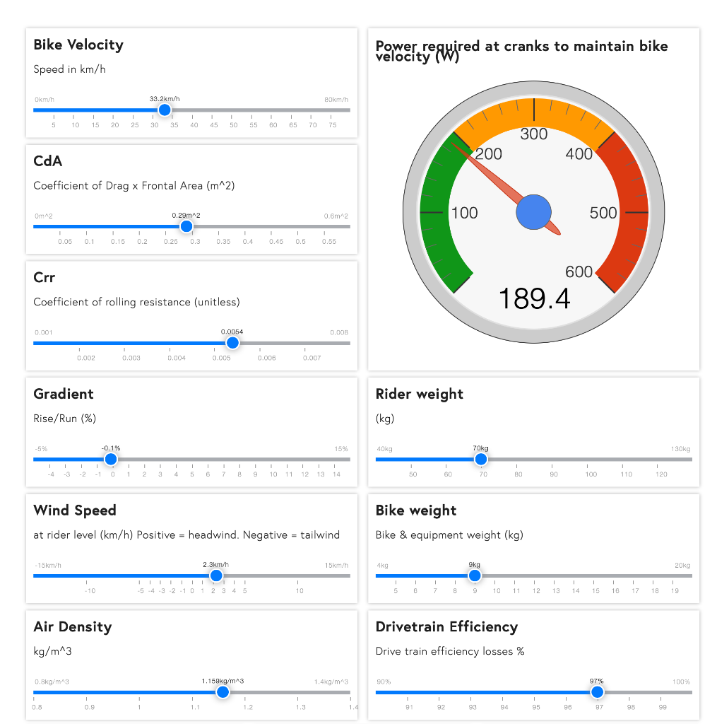

the website estimates 189.4W for 33.1 KM/h with 2.3 km/h headwind (test 1) (vs 198.2 DFPM measured)

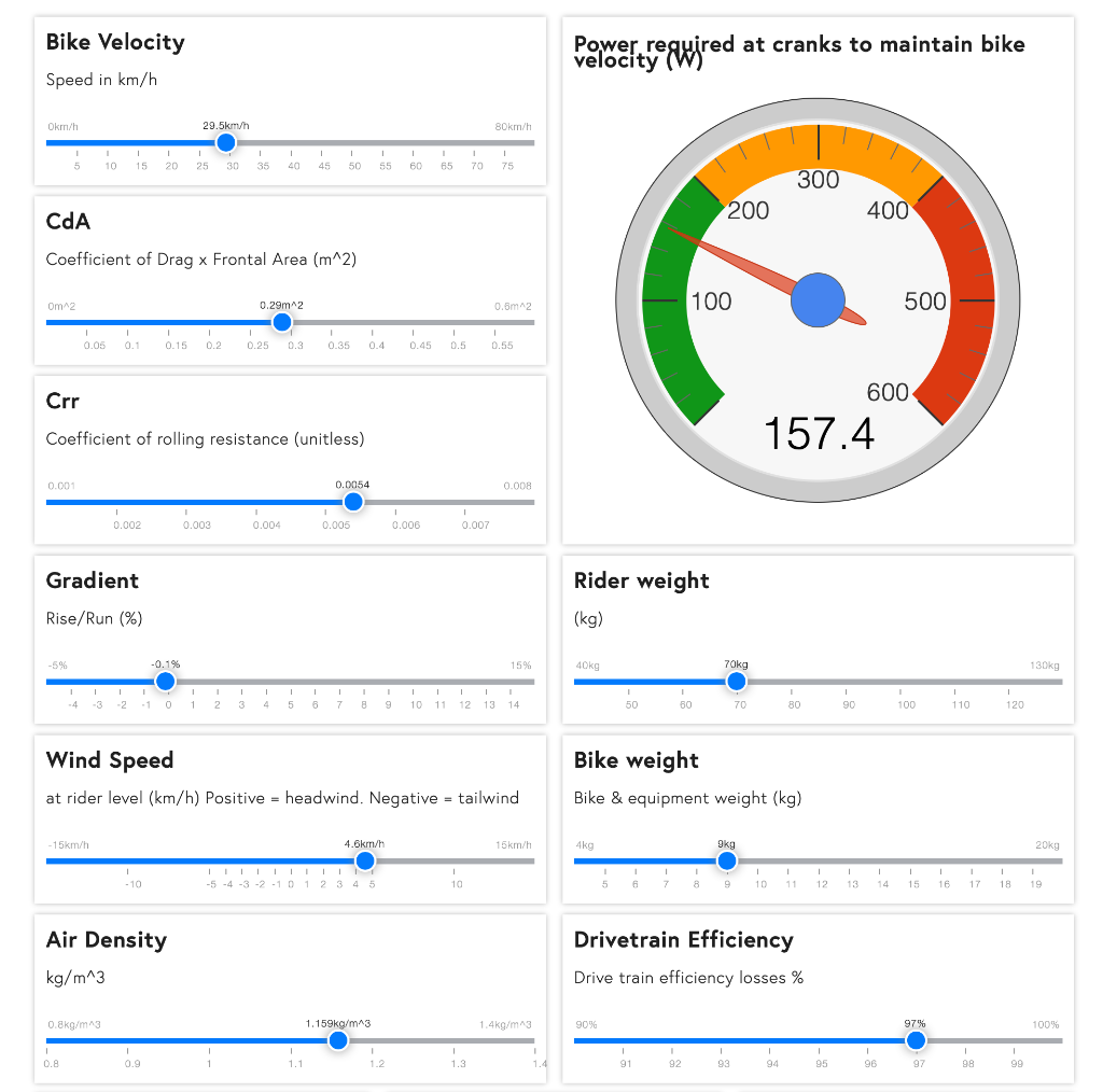

the website estimates 157.4W for 29.5 KM/h with a 4.6 km/h headwind (test 2) (vs 175.0 DFPM measured)
So, according to the website, decreasing your bike speed in the second road bike test should reduce DFPM watts by 32.0 W
There is a 6.8W DFPM watt discrepancy between road bike test 1 and 2; that is, the website predicts your DFPM watts should have decreased by 6.8W more watts than your measurements actually report. Said differently, your DFPM watts on test 2 were 6.8W HIGHER than predicted. Higher than predicted DFPM watts would force measured CdA down.
I did an estimate, reducing your test 2 DFPM watts from 173W to 166.2W (6.8W less). The AP CdA resulting from a 166.2W DFPM reading would be about 0.294--identical to your test 1 result.
