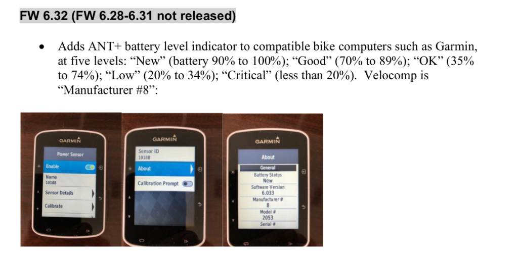

Flashing red LED when connected to USB means your AP battery is charging. Let it flash until the battery goes out (fully charged).
Here is a screen shot from the FW release notes, showing where to find AP battery status on Garmin.
- Screen Shot 2019-03-01 at 5.48.08 AM.png (326.93 KiB) Viewed 4597 times

Thanks. I'll check it out.
