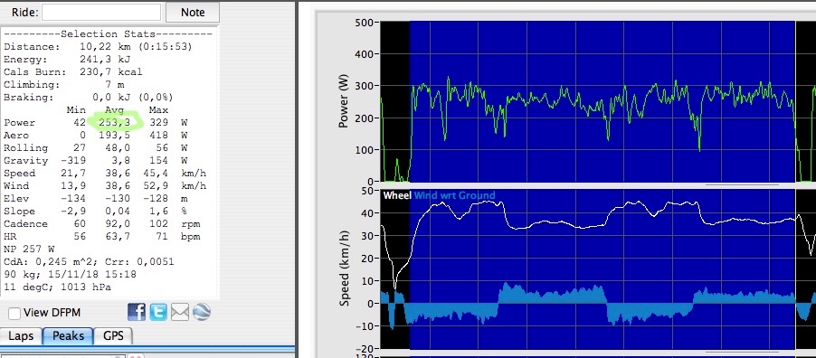

Hello, has anyone else seen this?
I'm getting significantly different power-values for intervals between the AeroPod .ibr-file and the data in the .fit-files with powerdata retransmitted from the AeroPod to my Garmin Edge 520:
The attachment Screenshot 2018-11-15_21-44-12-428.jpg is no longer available
The attachment Screenshot 2018-11-15_21-46-26-091.jpg is no longer available
If I plot the two datastreams, the pattern is very similar, but I'm actually not able to recognise data sequences between the two streams:
ibr power in Isaac
ibr power in Isaac
Screenshot 2018-11-15_21-44-12-428.jpg (130.63 KiB) Viewed 4649 times
I hope there's an explanation - perhaps a AeroPod-setting that should be changed?

Re: Differences in power-values between .ibr- & .fit-files
The numbers recorded in the .fit file come from the DFPM; the numbers in AeroPod are both AP power and DFPM power.
In your graph the "View DFPM" box is unchecked, so you're looking at AP power. The .fit file shows DFPM power. The difference is likely caused by the default value of CdA used in AP. If you increase your default CdA a little bit, you will get the same power numbers.
If you check the "View DFPM" box in Isaac, you should see a number close to the .fit recording.

Got it, thank you. When I check the box, the power numbers align. It also seems that the power numbers exported in TCX-files follow the checkbox setting; that's good.
