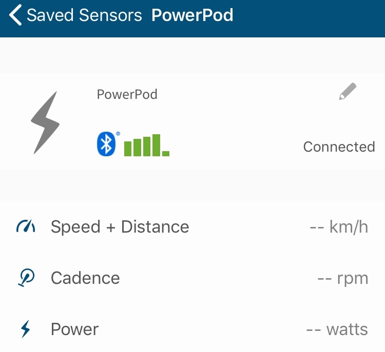

I forgot to attach screenshot from Wahoo App.

I answered my own question;
The Powerpod appears in the Wahoo App as a source for Power, Speed and Cadence. Even in a non-4 profile it doesn’t bridge heart rate so you still need a Bluetooth heart rate monitor.

Incidentally the device calls itself “powerpod” and not “Aeropod”. That wasn’t me being odd. I just hadn’t corrected it when I took the screenshot.
Re: Upgrading from Newton to Aeropod, & Wahoo TICKR
EHB wrote: Fri Oct 26, 2018 3:31 pm Incidentally the device calls itself “powerpod” and not “Aeropod”. That wasn’t me being odd. I just hadn’t corrected it when I took the screenshot.
Yes. It shares the same BLE chip with PowerPod.
