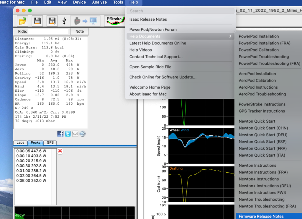

Posts: 8053
Re: New firmware, version 8.03, posted 9/27/21
meste wrote: Sat Feb 12, 2022 8:52 am Hi to all,
I was just updated to FW 9.0, so I came here to see what is all about, but I believe it is so new as I see no notice of that :-)
In Isaac, go to the link shown to learn about FW changes
Screen Shot 2022-02-12 at 12.24.19 PM.png (437 KiB) Viewed 26939 times
