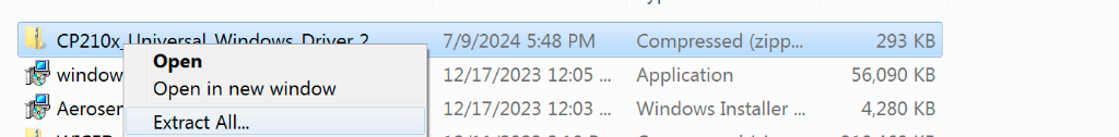

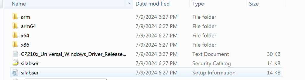

I've searched through all the extracted files in CP210x_Universal_Windows_Driver, and cannot locate the “silabser.inf”. And Velocomp Aero does not recognize the PP, but does so in Isaac .
Thanks Ken B.
There is this file, but is a text file. “silabser.inf”, but cannot execute (setup information)

3) RIGHT CLICK on the CP210x zip folder. You will see an "Extract All..." for the folder. SELECT "EXTRACT ALL..."

6) In the window you will find a "silabser" file with a type "setup information" (highlighted in the screenshot below)
Screenshot 5.png (85.51 KiB) Viewed 23840 times
7) Right-click on the silabser file, and select "Install"
