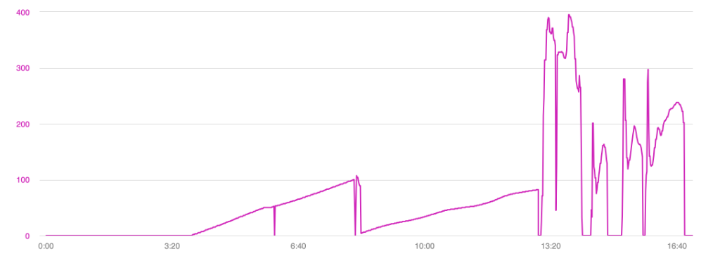

This is the V3 ride
Velocomp_2024_05_07_1536_1_km_HiDef.ibr
V3 Ride
(26.69 KiB) Downloaded 422 times
Power on the Garmin
Screenshot 2024-05-07 at 17.08.34.png (44.46 KiB) Viewed 10944 times

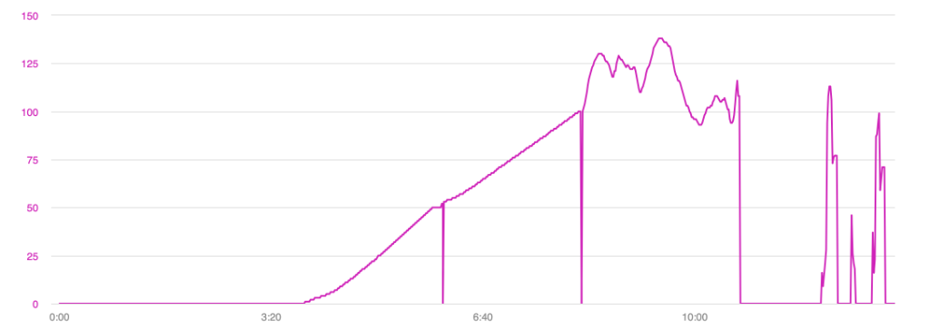

Here is the v5 files
Velocomp_2024_05_07_1616_1_km.ibr
(14.47 KiB) Downloaded 415 times
Screenshot 2024-05-07 at 17.09.14.png (49.96 KiB) Viewed 10944 times
