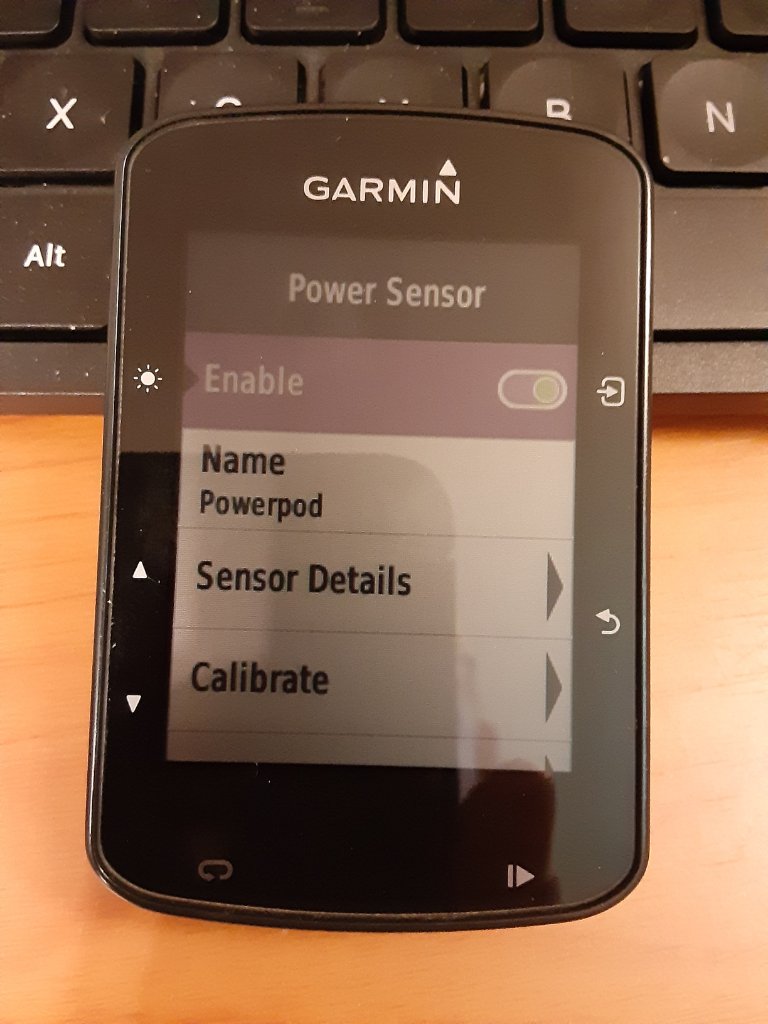

Re: weird Power numbers
This is very odd, because we do not transmit the word "PowerPod" by ANT+; only in our BLE transmission is the word "PowerPod" communicated.
Navigate to your Garmin sensor settings, find your power sensor, and take screen shots of what you find.
Hello John, I named the Powepod in the sensor settings in the Garmin 520+.
John, I have since, returned the PP name to the default ID in Garmin 520+.

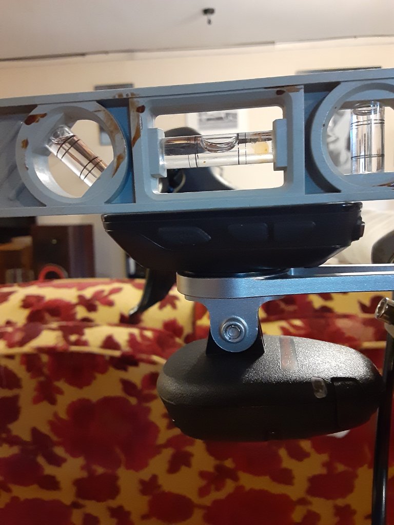

And before you ask, PP is level, hasn't change in years.
