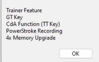

Posted: Fri Jun 17, 2022 10:46 am
by admiraljkb
Here are the keys applied to my PPv3, and have Favero Assioma Pedals attached.
Jeff
Re: AeroPod CdA
Posted: Fri Jun 17, 2022 1:52 pm
admiraljkb wrote: Fri Jun 17, 2022 10:46 am Here are the keys applied to my PPv3, and have Favero Assioma Pedals attached.
Jeff
That should work...
Please post .ibr ride file made with this combination.
