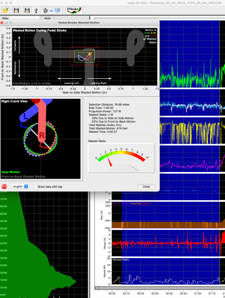

Hello,
I am now riding with the powerpod on 2 bikes and (according to me) there is a difference in wasted wats.
Can you have a look if everything is ok? If possible can you give me some tips to improve?
Kurt

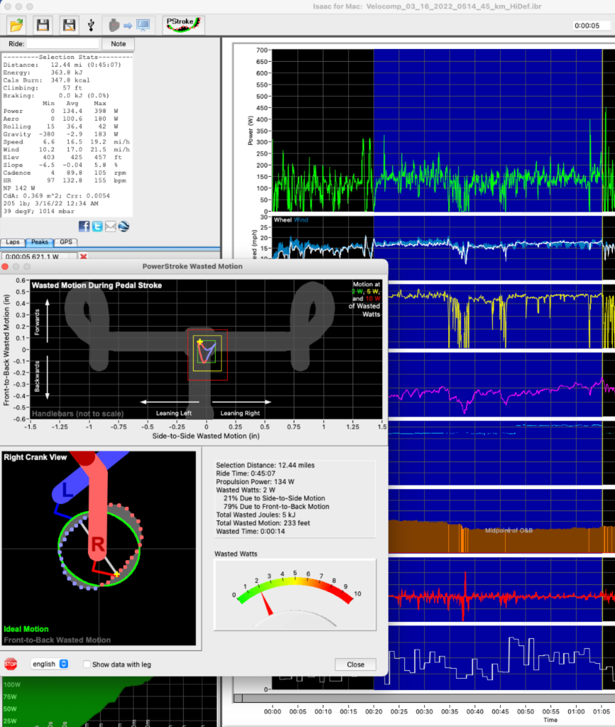

Your routes are different; the 64km ride had more hills.
Here is the PS for the flats portion of your 45km ride:
Screen Shot 2022-03-24 at 5.42.57 PM.png (408.12 KiB) Viewed 2692 times
Here is the PS for the flats portion of your 64km ride:
Screen Shot 2022-03-24 at 5.43.47 PM.png (348.53 KiB) Viewed 2692 times
Wasted watts are the same.
Both PS show a slight deviation from ideal. You might want to try pulling up a bit on one pedal as you push down with the other. This will lower your wasted watts a bit, and give you more pedaling economy.

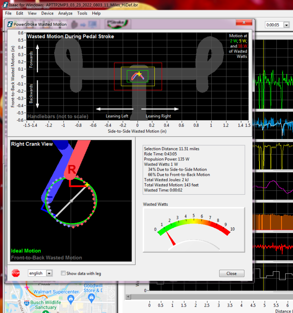

Here is a PS from a ride I did yesterday. You can see that it closely follows the green line...
Screen Shot 2022-03-24 at 5.47.21 PM.png (445.09 KiB) Viewed 2692 times
