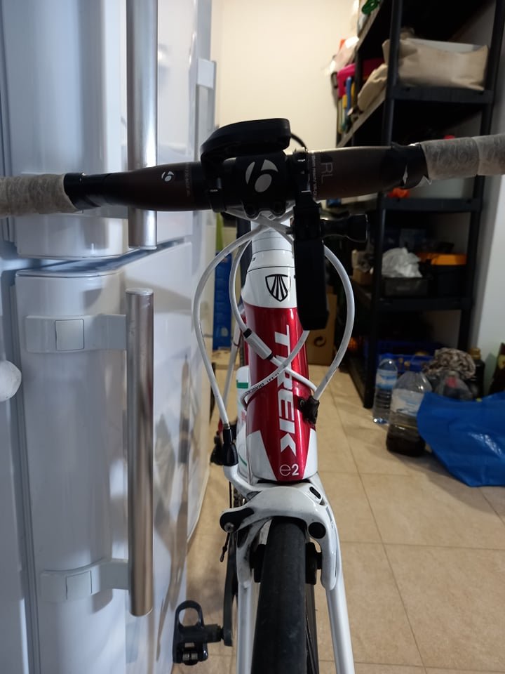

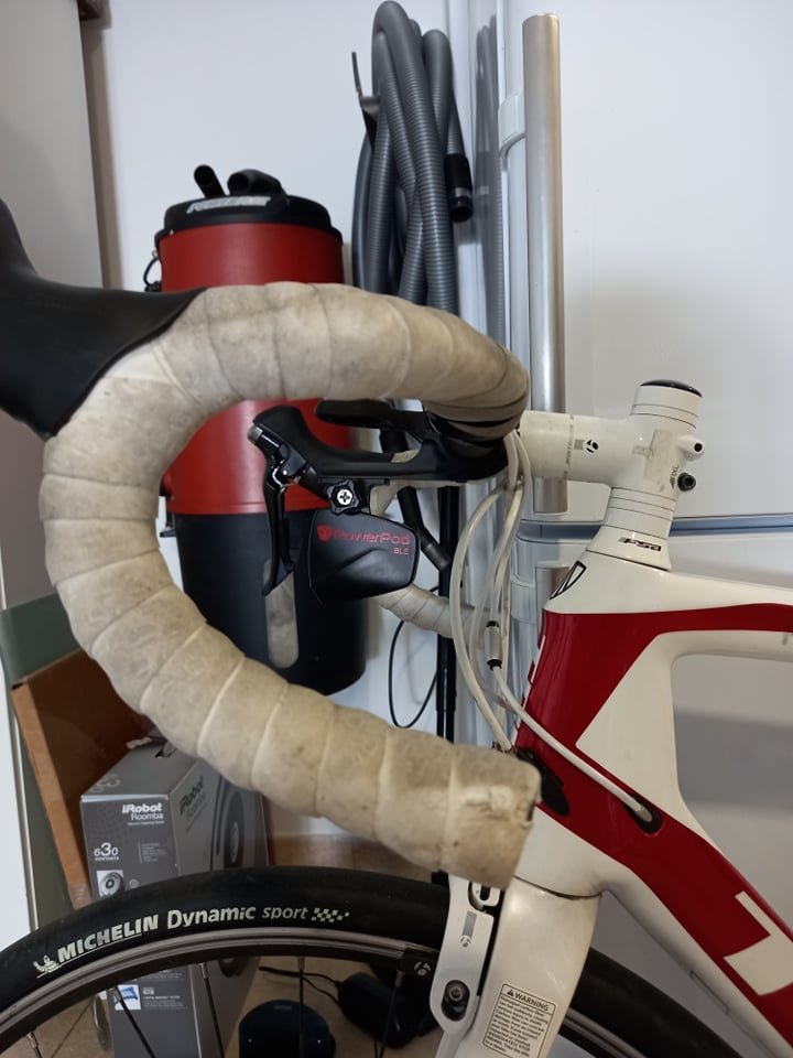

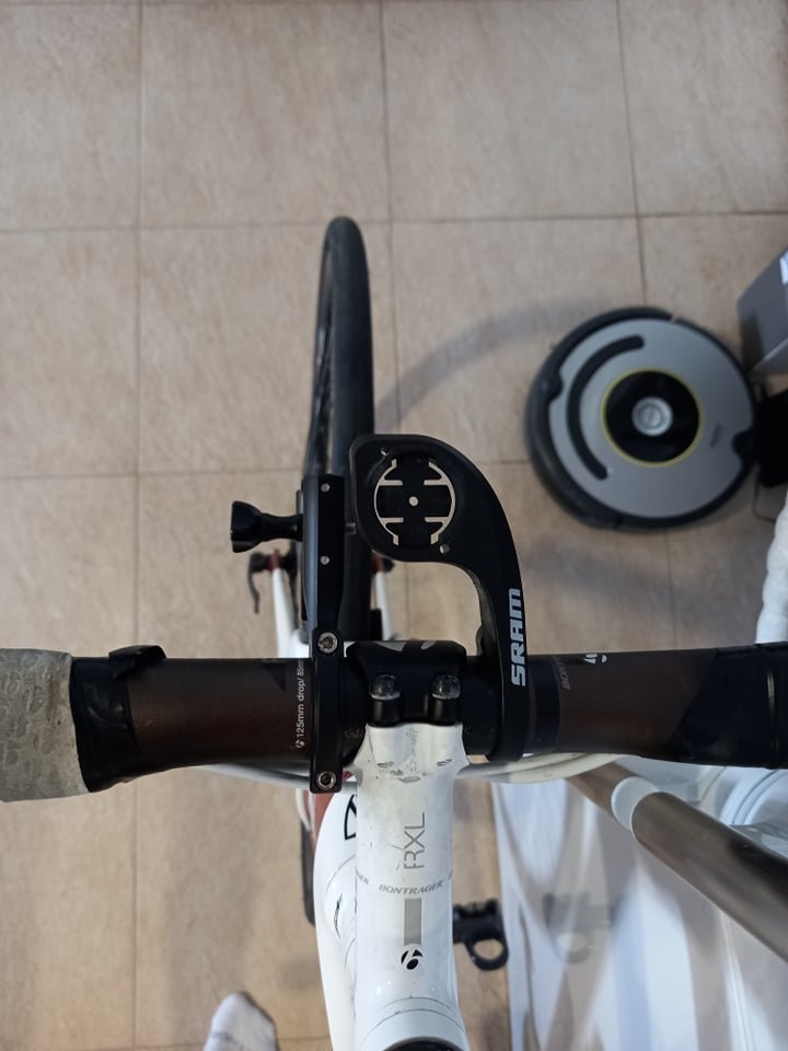

Please post photos showing your your unit is mounted to the bike; front, side, and top views.

I have the "front mount" setup". Last time I used it, it was already 3 year ago and was perfectly fine.
I have the "PowerPod" letters parallel to the floor

Hmm...set up is good.
