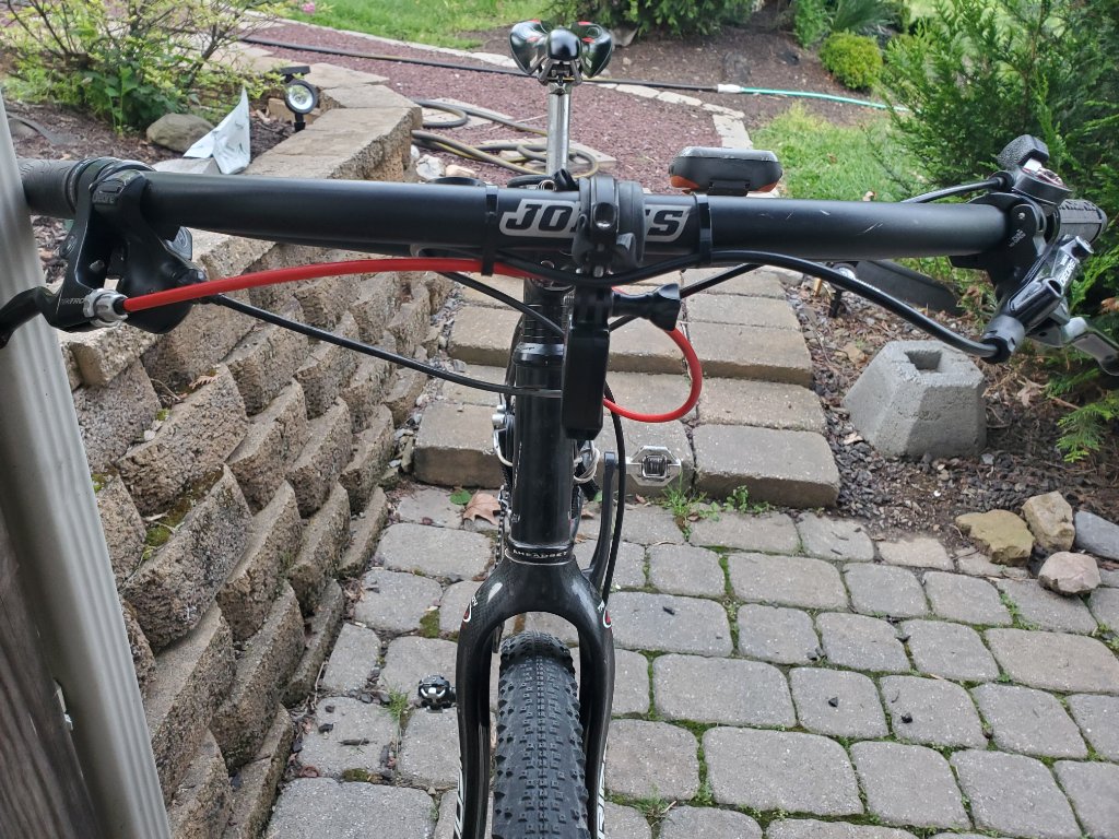

Gravel bike, 2" Compass Rat Trap Pass slick on back, 2.1" Thunder Burt on front. Jones loop handlebars with the PowerPod on the front loop.
