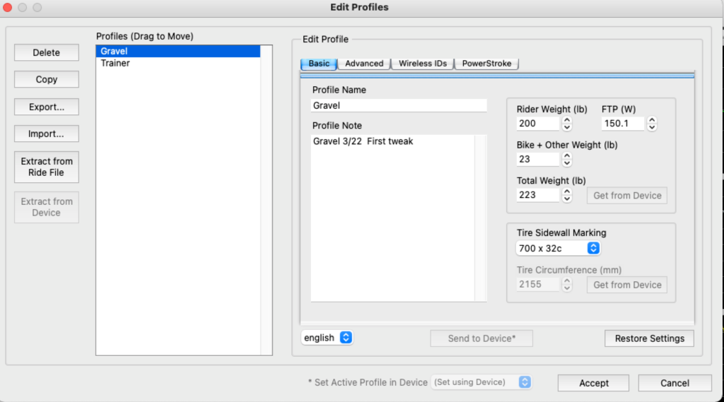

1. In Isaac you can go to Edit Profiles, and there set your wheel circumference to exactly 2218mm
Screen Shot 2021-04-03 at 10.19.12 AM.png (104.97 KiB) Viewed 3837 times
The EDIT Profile Screen.

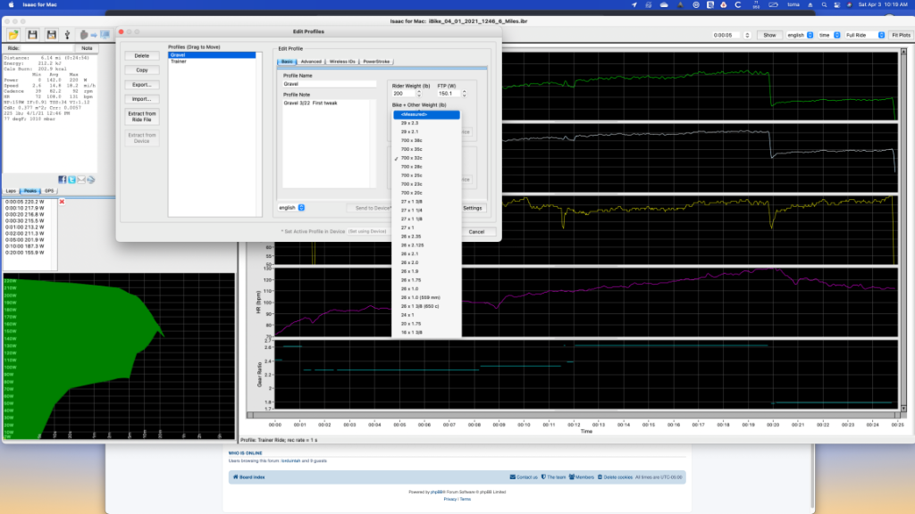

Screen Shot 2021-04-03 at 10.19.26 AM.png (244.82 KiB) Viewed 3837 times
Bringing the Tire Sidewall Marking list open as a DROP DOWN.
Notice the top entry <Measured> --- Select that choice by highlighting it.
Screen Shot 2021-04-03 at 10.19.40 AM.png (245.45 KiB) Viewed 3837 times
You can then change the value of the CIRCUMFERENCE - to your desired tire size. Then ACCEPT the changes and finally SEND TO DEVICE.
