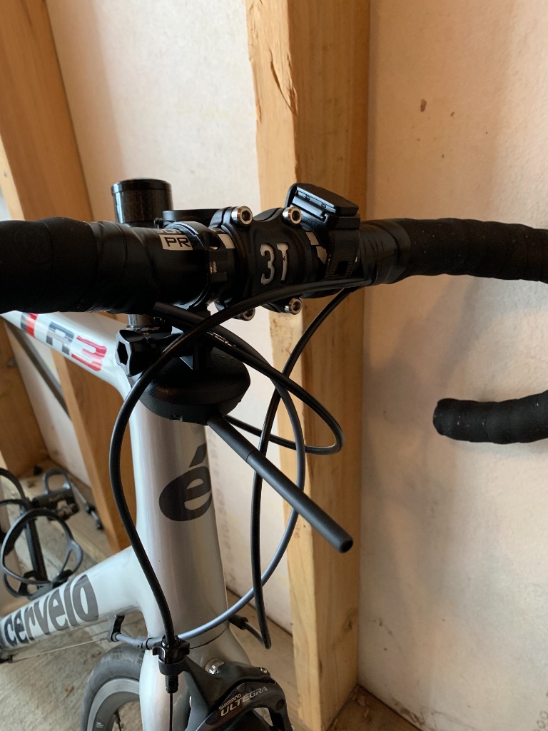

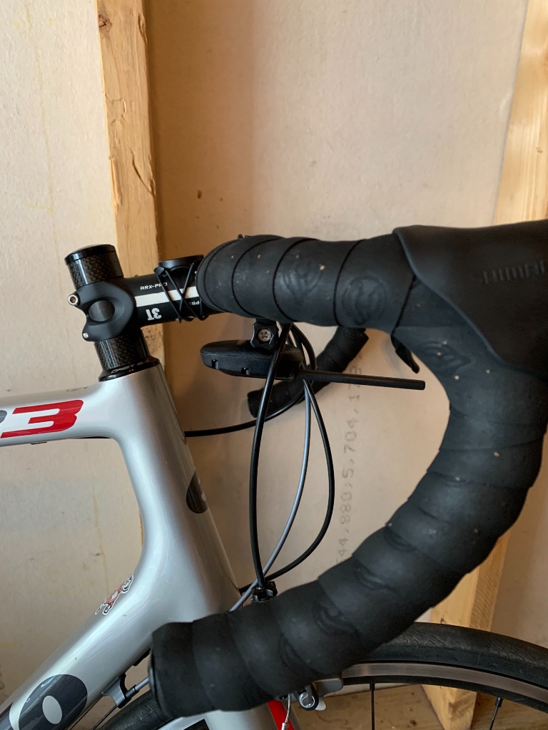

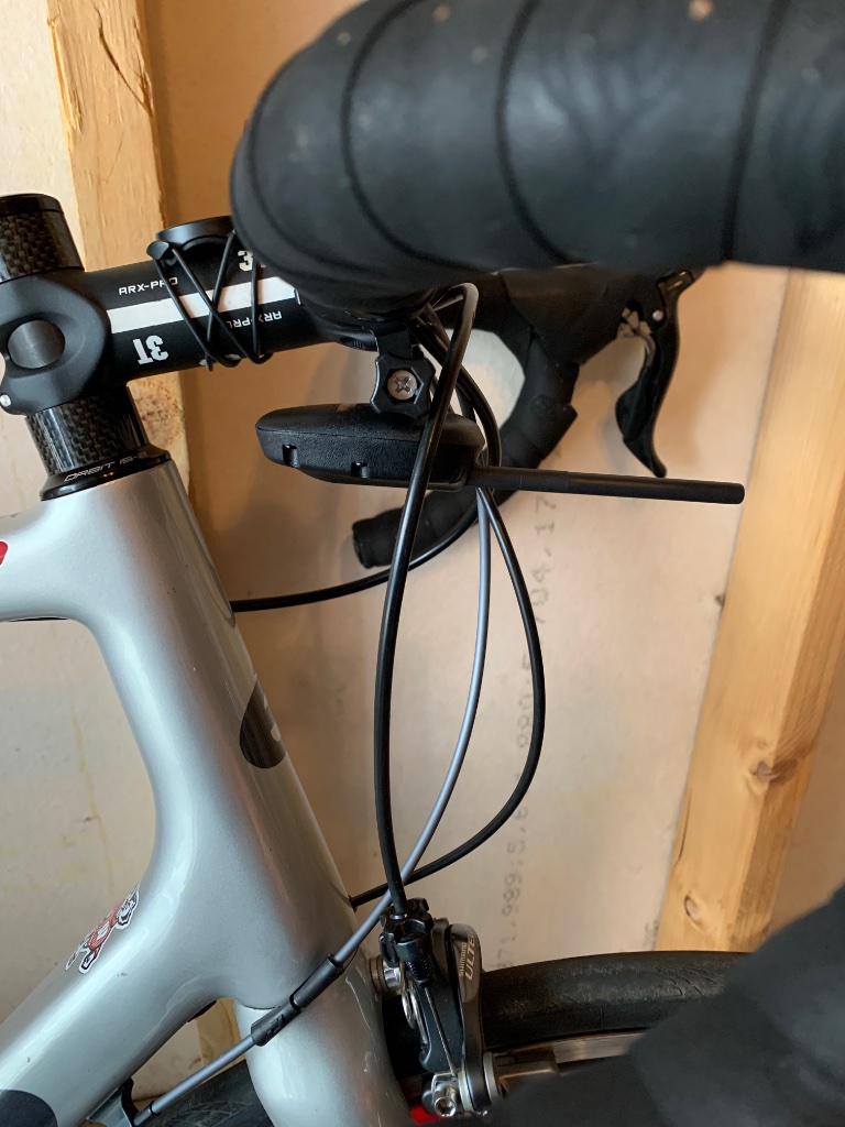

Please post images of your PP attached to your bike.

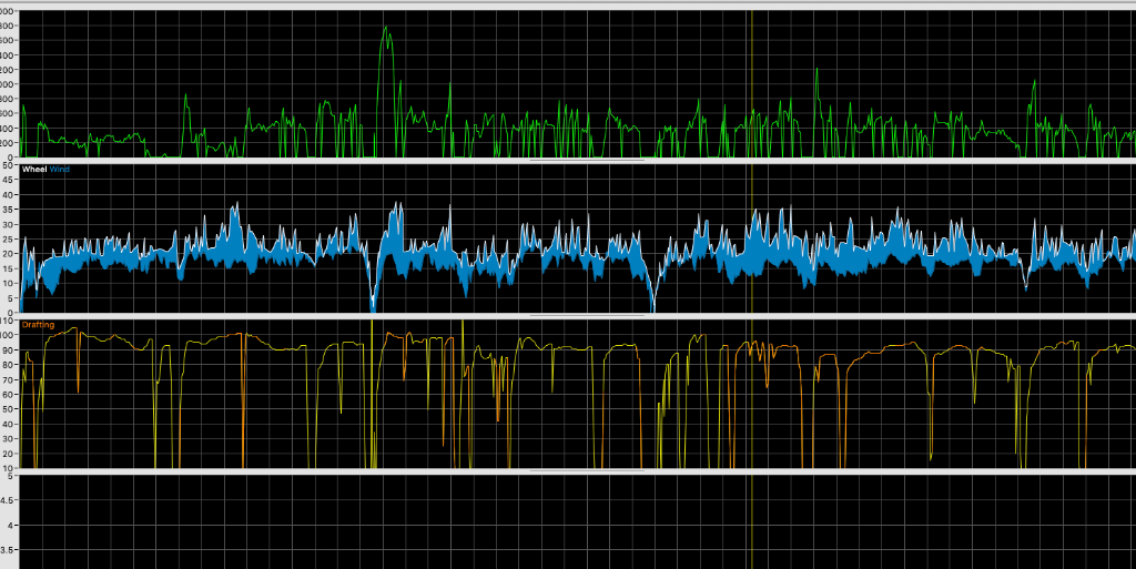

You have a problem with your speed sensor. It is very "noisy". What kind is it? Where is it attached? If it is a magnet less sensor it should be on your front hub.

I have the older garmin speed sensor that attaches to spoke. I’m attaching images of PP.

Also not sure what you mean by noisy? This ride we stopped a lot at lights etc so may not be the best? I can send other files if needed? thanks.
Re: Power seems far too high
velodan wrote: Mon Mar 22, 2021 4:26 pm Also not sure what you mean by noisy? This ride we stopped a lot at lights etc so may not be the best? I can send other files if needed? thanks.
Sorry, I should have been clearer.
In the ride file graph, bike speed is the white line. It should be fairly smooth, but in your case you will see many spikes sticking up, above the normal bike speed. This is incorrect, and means your speed sensor is not working properly. Also, when the spikes point up (higher bike speed) this will falsely increase watts above normal.
It sounds like you are using an older Garmin combined speed/cadence sensor. These are not recommended (see our website). I suggest you purchase new magnet less Garmin sensors. Mount the speed sensor on your front hub, do a new pairing and cal ride, and all will be well.

Ok I’ll do that. Is the PP mounted correctly? Just want make sure I have that part right as well.
velodan wrote: Tue Mar 23, 2021 9:19 am Ok I’ll do that. Is the PP mounted correctly? Just want make sure I have that part right as well.
Yes, the mounting position looks fine.
