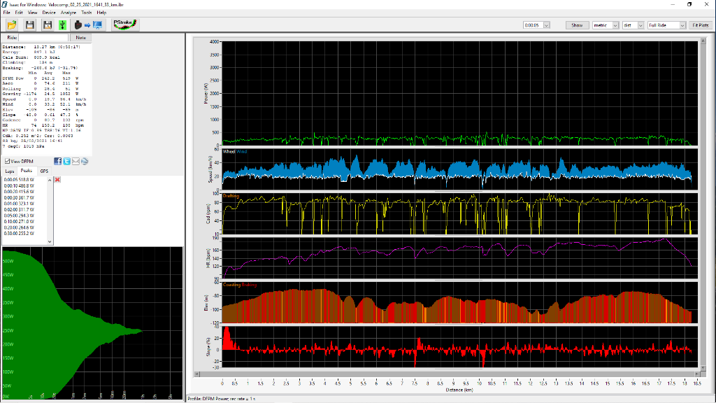

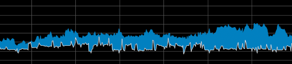

I've just started using my trusty PowerPod on my TT bike, planning to do some cdA analysis. It is paired to a Rotor DFPM and a Saris speed sensor fitted to the front hub. Weirdly the reported wheel speed is well below actual, and the recorded distance is also nearly half the actual. The examples below relate to a 34 km ride averaging 35 km/h. ISAAC shows it as 18.5km at around 19km/h.
I've re-run the setup, pairing and calibration process and the outcome is the same. Wheel size is set correctly I think. The PowerPod is working well on my other bike. The speed sensor is new and has a fresh battery. Has anyone experienced this issue before and is there an easy fix?

I'm not familiar with a Saris speed sensor. Please send photos of it as mounted on your bike. Are you using it with a magnet? If so send photos of magnet/sensor too.
Also, there is a huge amount of noise in the speed sensor channel; this is the likely cause of low speed readings. You might want to try removing the sensor battery, putting it in backwards for a moment (to reset it) then reinstalling it.
