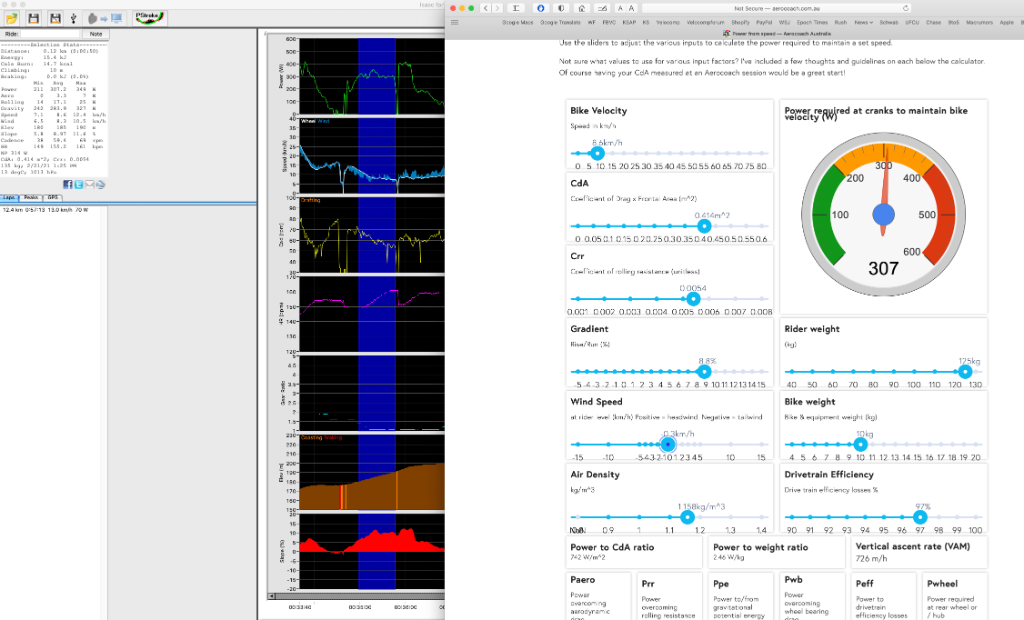

For the first 90 seconds of a ride the unit automatically self calibrates. During this period you might see low (or high) watts. In your case watts were low.
I checked a few places in your ride. On the flats, your speed was about 20 km/h. Measured watts for the interval I checked was spot-on with aero coach:

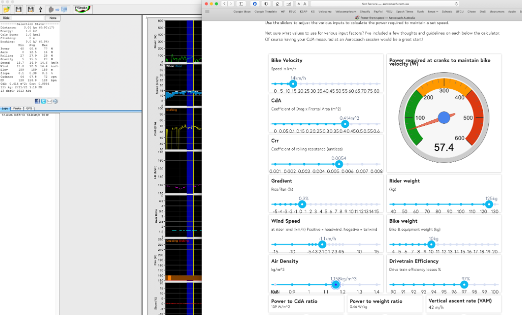

I then checked a hill. You were working much harder on the hill! Once again, watts are fine:

Whenever you start from zero, you'll see a spike in watts for a few seconds; this is the power you expend to deal with acceleration.
