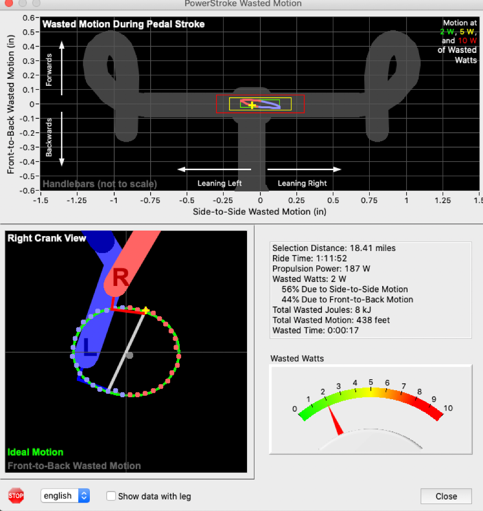

First, let me say that your 12/8 ride file is a nice example of a perfectly calibrated PowerPod! You were riding in a calm wind, and your wind speed is nearly identical to your bike speed.
Your PowerStroke is excellent, too; you have a very economical stroke, indicating that you pedal very smoothly on the bike.

Many thanks for the detailed response and explanation, John. I'll continue to use the 12/8 calibration. I did a mixed hill/flat ride (calm wind, some bursts) with it today again and compared afterwards by switching the profile to the original calibration of 12/6, and with your explanation indeed 12/8 looks better (avg windspeed and bike speed closer than with 12/6 cal). Watts vs heart beats also match closely with recent comparable rides. Powerstroke didn't look as nice as the 12/8, but still ok at 3W / yellow box and also expected as it was a much heavier ride (and I just found out you can actually do the powerstroke analysis for a selection of the ride, nice, looks like I have uphill wobbling to work on!). Thanks again, great to have such support via this forum, very glad to have now also reliable power measurements on my winter/gravel bike! Best, Joost
