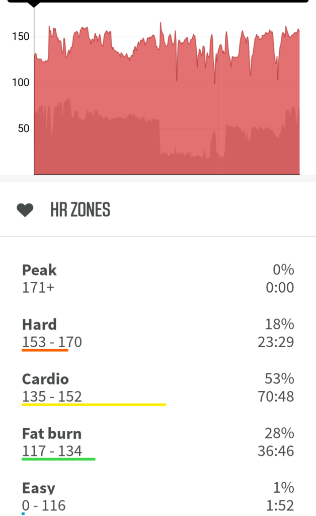

Regarding the other sensors: I did not wanted it to connect to cadence and heart sensors because it will get sketchy data.
My computer got clean data from the HR monitor (see attached pic).
Same thing happened during the first ride with the cadence sensor.
Thanks again for your help.
Also - if it loses it - will it suffice to run the "Analyse/Check Calibration" command and it will be done? YOUR CALIBRATION IS STORED IN MEMORY AND WON'T BE LOST. USE THE CHECK CALIBRATION FEATURE ONLY IF YOU SEE AN OBVIOUS PROBLEM IN YOUR RIDE FILE (WIND SPEED IS THE COMMON PROBLEM)
Same thing happened during the first ride with the cadence sensor. OK
