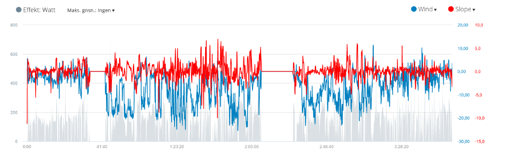

This is what you see for ride details for a ride in Garmin connect. For Aeropod two more data sets will be available. You need to install the PP Connect IQ app on your Garmin to have the data saved to the rides fit file. (The two gaps in the watt curve is due to a pause and a mechanical problem)
