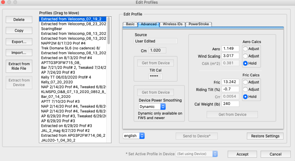

Do the following:
1) Connect your PP to Isaac
2) Go to Edit/Edit Profiles
3) Click "Extract from Device". This will extract the profile currently used
4) Click the "Advanced" tab. You will see 4.524 as your wind scaling
Screen Shot 2020-08-30 at 8.13.36 AM.png (168.33 KiB) Viewed 7003 times
5) Type 3.017 into the Wind Scaling window
Screen Shot 2020-08-30 at 8.17.06 AM.png (167.16 KiB) Viewed 7003 times
6) Click Send to Device
This will put the correct wind scaling into your profile.

Thanks for the support. The ride had the 4.524 value as I had already left before the correction was sent. I see that wind scaling in attached file ended up at 3.017.
