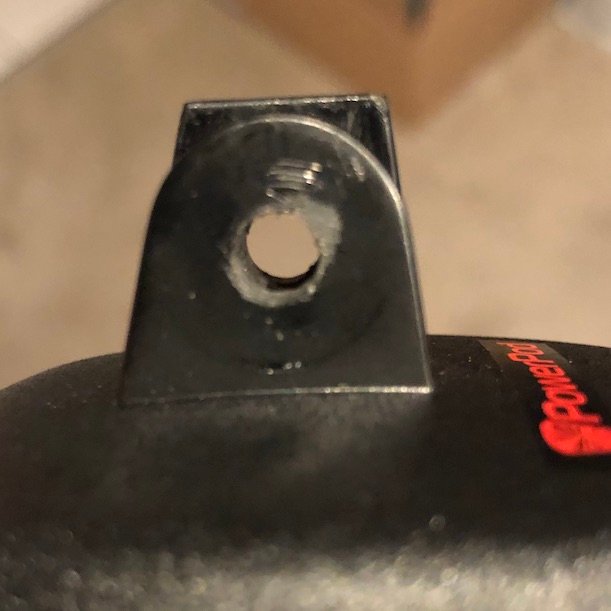

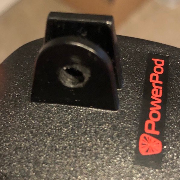

I recently took the plunge and purchased a PowerPod v3. I've done an O&B calibration and a couple of shortish rides so far, and the numbers look pretty reasonable to me, based on what I see on my static trainer. So far so good.
The reason I'm posting is to ask about the holes used to mount the PowerPod. The mounting bolt supplied did not fit through these holes out of the box, so when I first mounted the unit the bolt effectively had to act as a tap, boring a thread through the plastic of the tabs on the PP body. This made it extremely hard work to mount. In fact I resorted to a bolt of the same size and pitch so that I could use a hex key and get more leverage.
I removed the unit from my bike before cleaning it yesterday and I noticed that some of the plastic around the mounting holes has flaked away, presumably due of the stress of being bored thorough. Refitting the PP was difficult again.
My question is simply...is this normal?! I'm worried that the mounting attachment won't last long as I intend to swap the PP between a few different bikes - that being one of it's major selling points.
Thanks in advance!

I've attached a couple of images as requested. In one I've tried to show the groves in the mounting holes cut by the mounting bolt. In the other I've tried to show where some of the plastic around the mounting holes has flaked away. (Not the best photos I'm afraid. It's hard to get the phone to focus on totally black detail.)
I fully appreciate your position. You've manufactured hundreds / thousands of these units and I may be the first person asking this question. Plus I've run the bolt through it now, so I can't prove that it didn't slide through unimpeded straight out of the box. I'm asking you to trust me, it didn't!
I don't think there's anything can be done for now anyway. As I said, I plan to move this between a number of bikes, utilising the GoPro mounts I already had for hanging lights under my Garmin in the winter. I'll keep an eye on the wear this causes and report back if it worsens.
One thing I have noticed is that the central 'prong' (for want of a better description) of the mount you provide with the PP is chamfered. None of my GoPro mounts, or any I've looked at online, have the same. The chamfering makes it much easier to align everything.
