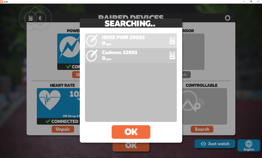

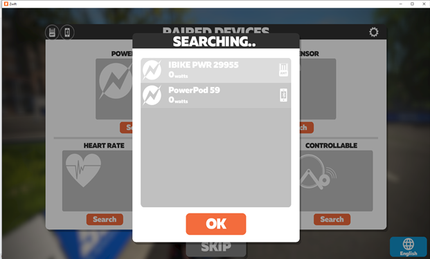

I also like to connect my Zwift Cadence using PowerPod than Garmin Cadence Sensor because it has less drop than the Garmin. So the PowerPod (Power and Cadence) and Garmin HRM-Dual is the only device connected in Zwift (PC ANT+ or Companion App). But it causes a little delay in display. Do I connect it right?
Which one is the best IBIKE PWR (ANT) or PowerPod (BLE) for Zwift Power?
I can't connect my PowerPod to both my Zwift and Garmin to display my watts. Does it only accept one device to display?

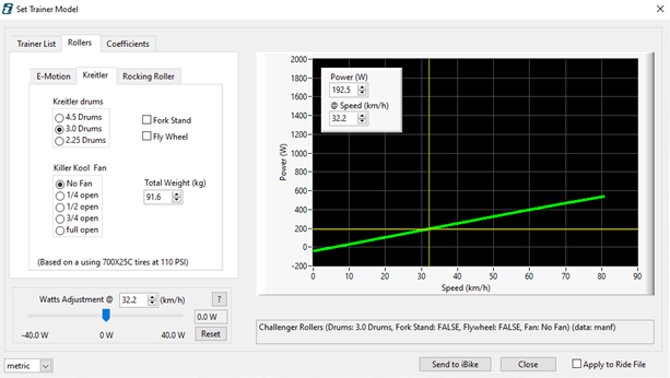

Is there something wrong in my setup (Device > Set Trainer Model > Rollers > Kreitler)?
Drums = 3.0, Fork Stand = No , Fly Wheel = No, Fan = No, Weight = 91.6 (including rider, bike, and accessories), Adjustment = 32.2 km/h (0.0W), Power = 192.5 @ Speed 32.2 (default)
Or should I used Trainer List (Can’t find my roller model) or Coefficients (More Compicated)?
