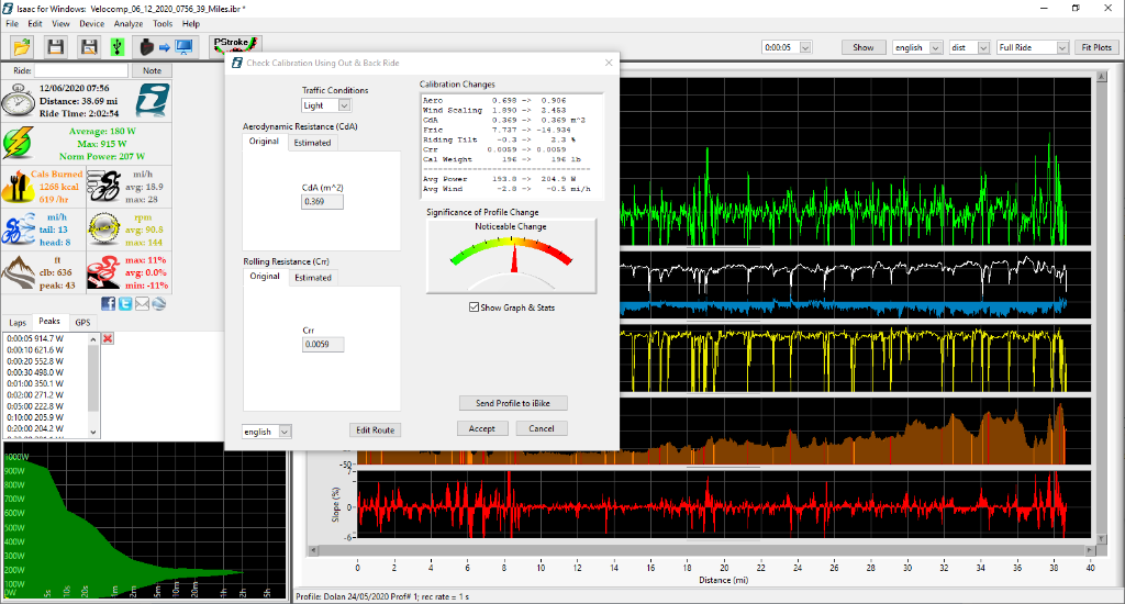

I've been tinkering with set up to try and get some sort of consistency with my Edge 1030 (4 weeks into powerpod ownership) and thought I'd got to the point where I had my edge set properly. Was getting a lot more consistent readings and less spikey power results.
Today I switched to my winter commuter due to cr4p weather and it having mudguards. Also, decided to "check calibration" as I'd only done an out and back previously on that back.
Garmin said Avg power at 193 watts. The summary ride file in ISAAC says avg 180. It felt like a ride where ISAAC said I'd average 190-200 on my other bike. Yet in the "Check calibration" ISAAC itself says analysed 194 watts so inline with garmin and the calibration puts it up to 205 watts if I accept it. I havent done as that'd put it over my garmin and not sure I believe it just yet.I did have to stop to plug a puncture so my garmin autopauses which could be part of the garmin to isaac difference it it keeps recording.

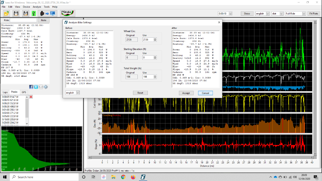

What's going on here....I can understand garmin giving a different reading but ISAAC; surely it should give me consistent results? Am i reading it wrong? Boxes on the left say avg 180 yet the calibration box says something different. see screenshot. And ridefile also attached.

Thanks. I can understand the garmin to isaac differences but within isaac why does the avg show 180 in the ride summary but PRE calibration at 193?

You are not using Check Calibration according to the instructions. This is not an out and back ride. It is not surprising the window is showing different numbers.

Re: Confused with averages again.
I’m also seeing the avg at 194 in all of the “analyse” windows too....even if i’m using the calibrate incorrectly the ride summary window isnt consistent with the other windows.
Thats the power avg thats confusing me. Is this rides avg 180 or is it 194?

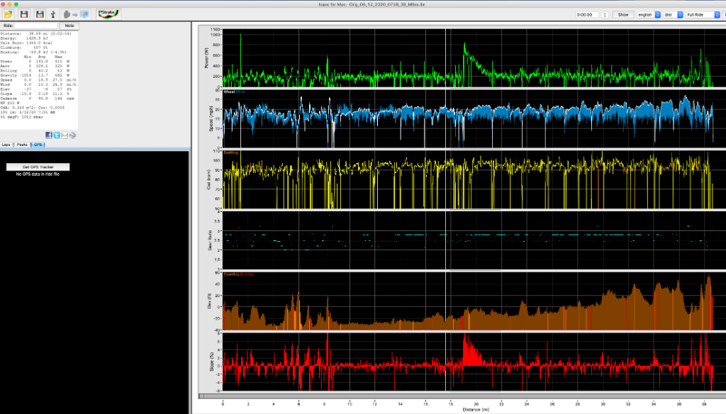

I just noticed that your ride file as posted has been analyzed by Isaac; the "180" value you are seeing is a result of that processing.
To see the original data recorded by your PP, use the "Analyze/Return to Original download" command.
Original ride file is attached.
The original file has the 193W value, and you will why it is higher. At the 19 mile mark it looks like you stopped, and that your PP was bumped out of position. There are crazy-high watts for the first mile when you start riding again, after which everything returns to normal.
So, what has happened is that your Garmin is correctly reporting the 193W value, because that is the actual number recorded by your PP. But the 180 number is the correct number, because the corrected ride file gets rid of the bumped device problem at mile 19.
To get consistent results make sure you don't bump your PP during the ride
