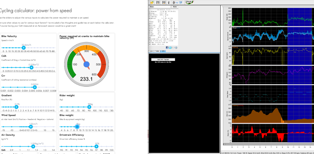

I analyzed the threshold stretch on 5/6, and the comparable section of your 5/9 ride
I see the following:
1) Your PP looks to be properly calibrated. I say this because wind speed and slope readings are within range
2) Wind strength and direction varies considerably between these rides
3) On your 5/6 ride you had a slight headwind in the threshold interval. An aero coach analysis shows that PP measured 234 watts is very close to calculated 233 watts
Screen Shot 2020-05-09 at 5.45.51 PM.png (185.92 KiB) Viewed 3952 times

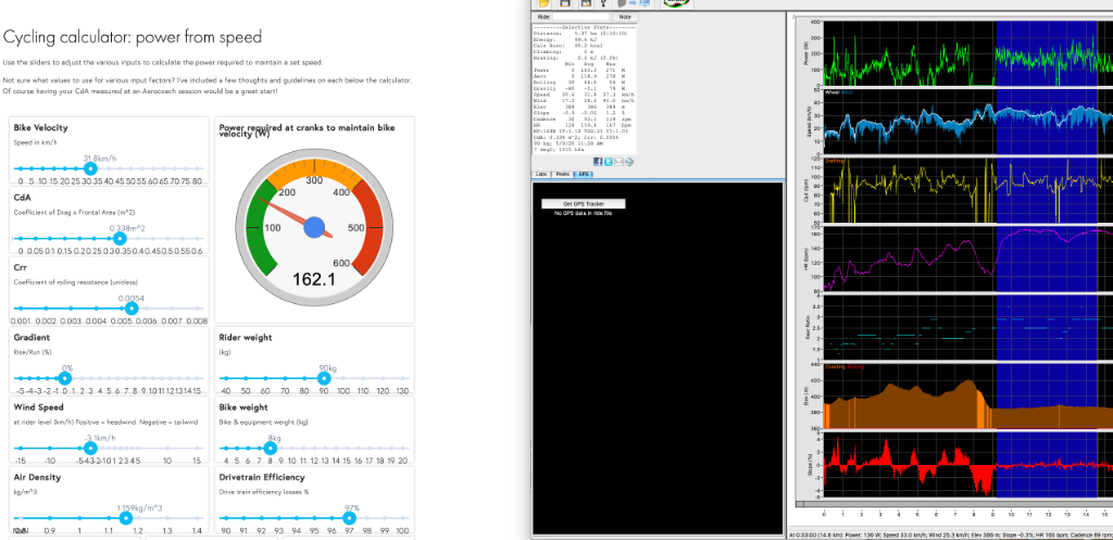

On the 5/9 ride you had a pretty significant tail wind in the same section. Also, your bike speed was lower. You were not working as hard...
Screen Shot 2020-05-09 at 5.43.42 PM.png (194.19 KiB) Viewed 3952 times
PP measured 163W; aero coach calculates 162W
In both cases, calculated and actual watts are extremely close!
The power data suggests that you did not work as hard on the 5/9 ride, and the sensor data (wind, slope and speed) support this conclusion.
