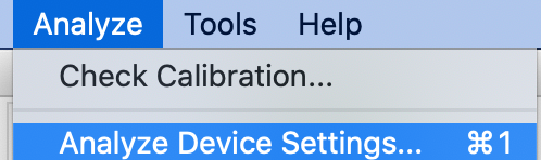

1) Elevation readings are based on baro sensor readings. Baro readings vary with weather.
You can adjust your absolute elevation, after each ride, with this command:

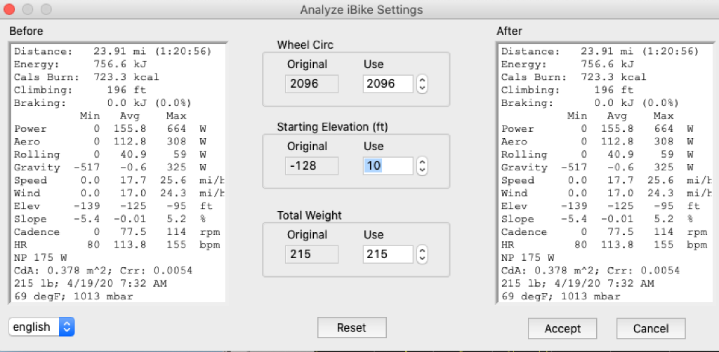

In this ride file I changed starting elevation from -128 feet to +10 feet
Note that changing the absolute elevation won't affect power readings

Great, thanks John. I'll keep the tweaking to a minimum. I should have mentioned I've adjusted the elevation using the method you show but was wondering if there was a more "permanent" fix. I suppose if pressure changes regularly with weather then that's not meaningfully possible, but it must default to assuming a specific pressure is sea-level e.g. 101.3 kPa.

The tweaked elevation value is not transmitted to your PP profile. So, if you want elevation "exact" you'll have to adjust it in each of your ride files
