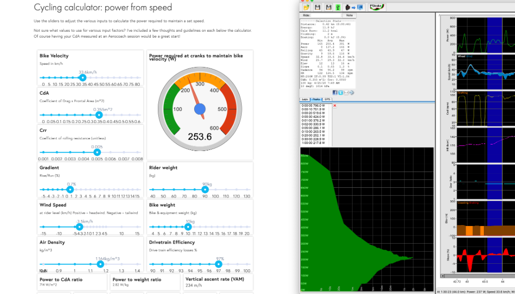

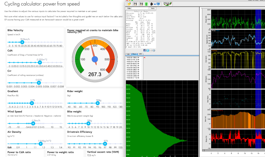

Re: Aligning Power on different bikes
This profile looks to be perfectly calibrated.'
I took two sections of your ride, one on a hill, one on the flats, and compared PP data to aero coach. Hills and flats checks the calibration of the accelerometer and wind sensor respectively.
Your device is working very well.
- Screen Shot 2020-05-08 at 12.49.28 PM.png (259.06 KiB) Viewed 7999 times
- Screen Shot 2020-05-08 at 12.54.38 PM.png (210.7 KiB) Viewed 7999 times
