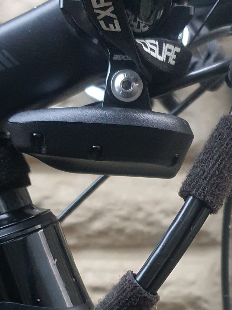

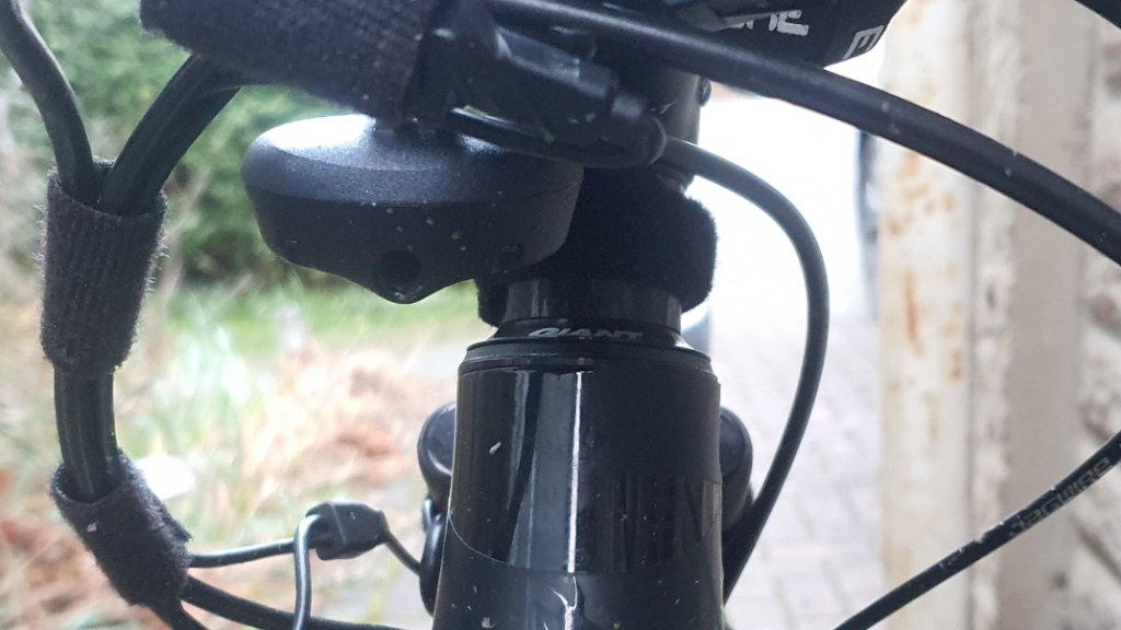

Your wind readings are very low. Please post front and side images of your PP mounted on your bike.

See photos of PowerPod v3 mounting on Giant Anthem X 29er
- Mount was originally used with a PowerPod v2 unit and its position is unchanged from that usage.
PowerPod v3 mounted on Giant Anthem X 29er - Front view
PowerPod v3 mounted on Giant Anthem X 29er - Right-hand side view

Please email technicalsupport@velocomp.com with a copy of your ride file. Tom will give you next steps.
