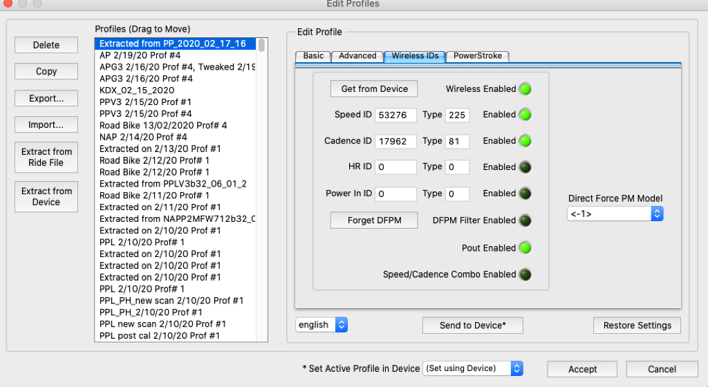

I see two problems:
1) your 1604 "no cadence" ride shows a paired cadence sensor in its profile (the same cadence sensor ID as in your "paired cadence sensor" profile).
Screen Shot 2020-02-23 at 11.13.55 AM.png (162.04 KiB) Viewed 73953 times
So, when you did your no-cadence pairing, your cadence sensor was on (if cadence sensor was off, wireless ID would be 0). Please do another PP pairing, making 100% sure your cadence sensor is off. After you do this, you can extract the profile in Isaac, and confirm that the cadence sensor wireless ID is "0".
When PP has "0" for the cadence sensor then PP won't retransmit any cadence signals, and the cadence signal you see on your Garmin will come directly from the cadence sensor.

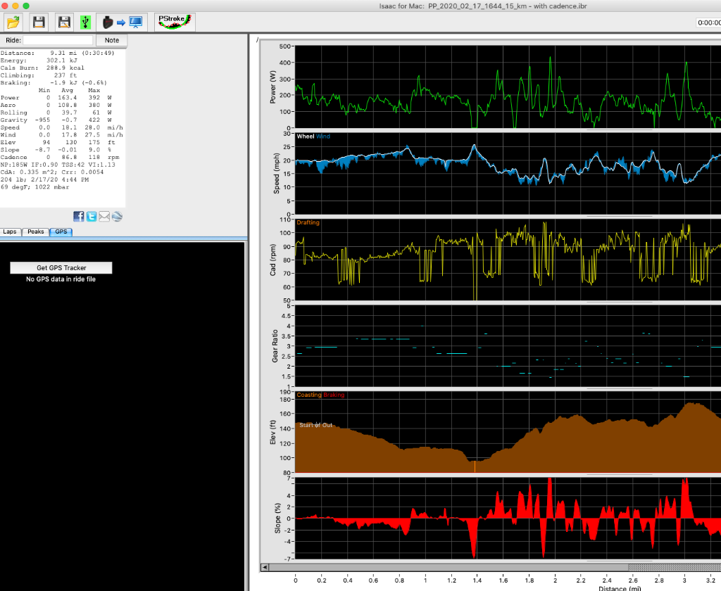

2) Your 1644 ride reveals the cause of your cadence dropouts. What's happening is that PP is getting intermittent signals from the cadence sensor, causing cadence dropouts in PP. You can see this in your ride file by setting ride file filtering to 0.
Screen Shot 2020-02-23 at 11.04.38 AM.png (216.8 KiB) Viewed 73953 times
When PP is paired with your cadence sensor, PP transmits BOTH power AND cadence signals together in the power channel (this is an ANT+ standard). So, your Garmin is reading the intermittent cadence numbers transmitted by PP.
I don't know why PP is having problems receiving a reliable cadence signal; it seems likely that your cadence sensor is not transmitting a strong signal.
I have been using a Garmin cadence sensor, identical to yours, for 4 years now, without problems. You might want to see if Garmin will swap your cadence sensor under warranty.
In the mean time, the easy workaround is to do a PP sensor pairing, making sure the cadence sensor is off. In this mode you won't directly get cadence data in your ride file, but you won't see dropouts either. After the ride you can merge your Garmin .gpx data into your PP ride file to add both cadence and GPS data to your Isaac ride file.
Very strange, I don't understand why it would show the cadence sensor connected when the Garmin 530 showed it was inactive. It didn't collect any cadence data for the PP either, so it doesn't make sense. I will do it again with the battery out of the cadence sensor. I will also check in with Garmin about this. At this point, it does seem like it might be a sensor issue.
Thanks for troubleshooting with me.

I recalibrated and did another ride. I wanted to give the cadence another last shot just in case is was a weird pairing/setup. I deleted all sensors from my Garmin and reset my powerpod to remove all profiles/data in Isaac then deleted and reinstalled Isaac. I removed and replaced the batteries in the speed/cadence sensors with fresh ones, inserting backwards for 10 seconds first to "reset" them (not sure if this makes any difference). I connected the clean PP to Isaac and set up a new profile with my relevant info. I then paired the speed and cadence sensors to the PP and initiated the calibration (flashing green/red). I added the sensors back on my Garmin, went to my ride location and initiated the calibration. Did the calibration and with the cadence sensor but the drops returned.
So I removed the battery from the cadence sensor, hard reset the PP, and redid the calibration without the cadence sensor active. I then added the cadence sensor back to the garmin and rode. No drops, PP data looked good, lack of cadence sensor didn't really seem to make a noticeable difference to power values.
I got home and downloaded the PP data. Weirdly, there was only a single calibration file despite doing two calibrations, and it showed cadence values so it was the first one. But the ride file profile did not show a cadence sensor enabled, so it appears to not currently be active. I tweaked the calibration with the ride data, made no real difference, looks good comparable to estimates using online calculators for power based on similar input data (168-180 W).
If it helps in any way I've uploaded the ride file (I cut out the cool down portion at the end so it was a true out and back).
Otherwise, I am happy now. I will probably contact garmin but I'm not too worried about it as I don't plan to use the powerstroke software (neat but probably not useful for someone at my level).
Thanks for the assistance John and others.
