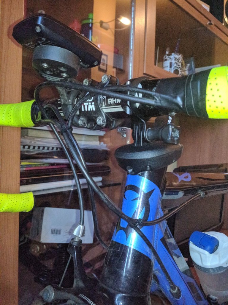

Hi, I've correctely paire my PP with cadence/speed sensor and with the bryton 330 head unit. I've created a new device profile in Isaac and sent it to the PP. Then I've started a O&B calibration. Calibration seemed to be ok and reasonable power data started to appear on my device. At this point I continued riding with some other cyclist but after a while the power data looked unreasonable even if i was out of the draft. So I decided to leave my ride mates and continued my ride alone, with NO drafting. Power data looked suspiciously low (like 70 watts @ 30 km/h).
So I resetted PP via Isaac and created another profile from scratch. Well, from this moment on I couldn't manage to complete a O&B calibration ride. When 100% is reached, red light flashes and absurd powerdata are shown (like 15000 watts or so) and the calibration restart again but seems impossible to complete with success. I tried to reset from Isaac and from device (10-12 seconds pressing button) but I'm stuck in this loop.
I also tried different horizontal angles but this did not affect in any way the result. Here is a picture of my last configuration (with PP slightly pointing down)
IN attachement you can see the first calibration ride and the last one.

There appears to be a problem with your wind sensor.
