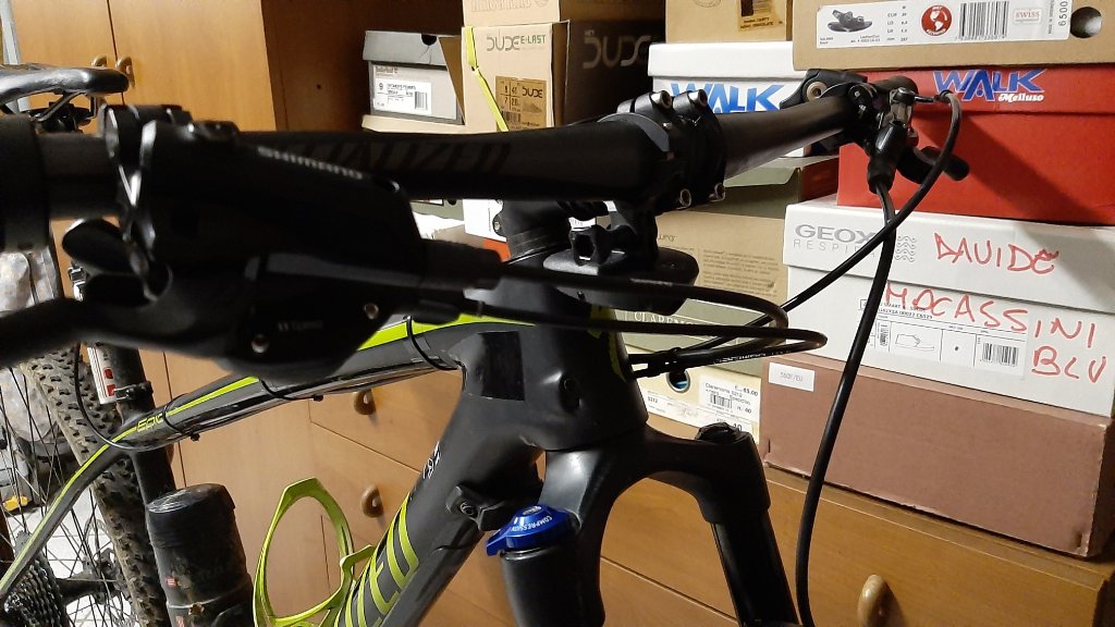

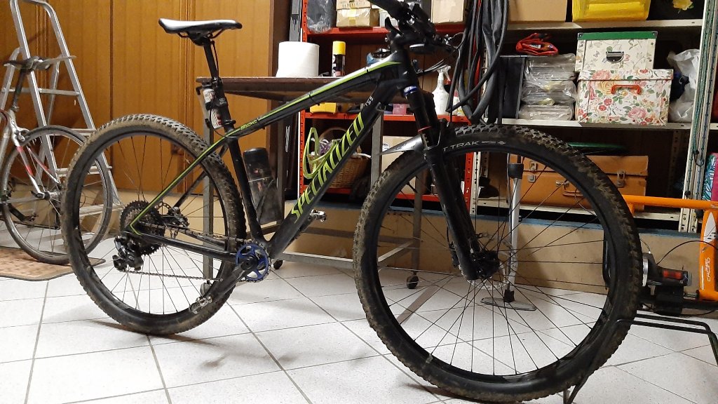

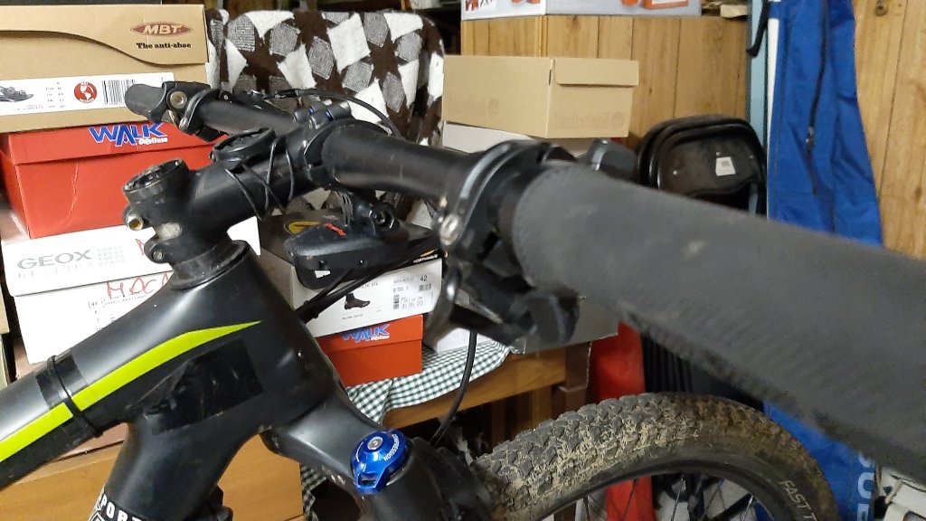

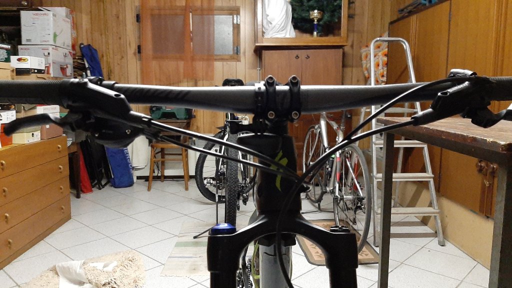

What kind of bike are you riding? Please attach photos showing how your device is attached to your bike.doib wrote: ↑Tue Nov 12, 2019 12:09 pm Thank you very much John for the quick and complete answer. It seems that I was wrong to load the third file, in fact it had to be a ride of 21 km, not 1 km ... I try to reload it. Sorry for the mistake, whitout that ride I guess you could not understand much of what I wrote..

Sorry for the delay, I could only take pictures last night. My bike is a 29er mtb, with a 2.3" front tire (1.4 bar pressure) and a 2.2" rear tire (1.6 bar). Probably the brake and transmission cables interfere a little, but I was afraid that a more external assembly would expose the powerpod too much in case of falls and bumps. I intend to mount the powerpod also on the two other bikes you see in the background, one road and the other always mtb (but I use it for tourism). On these two, a more external assembly would not be a problem.
- D_20191113_193643.jpg (142.08 KiB) Viewed 9812 times
- C_20191113_193557.jpg (135.16 KiB) Viewed 9812 times
- B_20191113_193910.jpg (210.06 KiB) Viewed 9812 times

An image of the whole bike.
- A_20191113_193759.jpg (180.62 KiB) Viewed 9812 times

Your CdA is low for a mountain bike; I have adjusted your profile. Other than that your calibration is fine!
You will get more consistent results on uphills if you lock-out your fork during your climbs.

Thank you a lot John!! A last question, about the position of powerpod...do you think i have to move it or it will work fine despite the cables you see in the pictures?
Re: Powerpod v3 - 4000 watts on cal ride
I don't see a lot of wind obstruction in your ride file, so at this point I don't think you need to move anything.

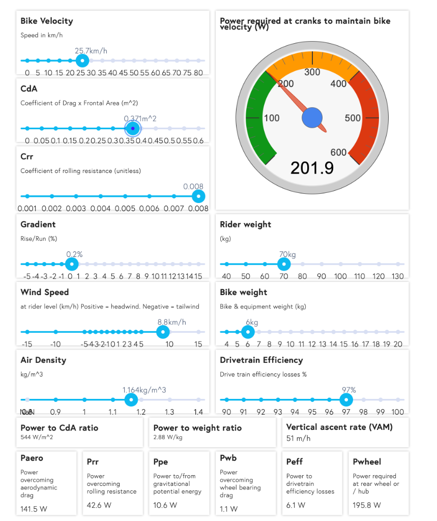

Just after km32 you had a short burst of 200W in a strong headwind. This seems normal to me, and was confirmed in aero coachdoib wrote: ↑Wed Nov 27, 2019 8:25 am Hello John,
can you please take a look at this ride, where I had very high watts just left and immediately after a long descent (at about km 32, slightly downhill and pedaling slowly my PP v3 gave me about 200 watts)?
What can it depend on?
Tank you, regards.
Davide
- Screen Shot 2019-11-27 at 8.55.29 AM.png (235.39 KiB) Viewed 9655 times
Sorry John, I saw an error in the image ... I weigh 61 kg and the bike loaded with equipment, clothing and water 15, while the image shows 70 kg for me and 6 kg for the bike ...
61+15 = 76 = 70 + 6
It's the total weight that counts.
