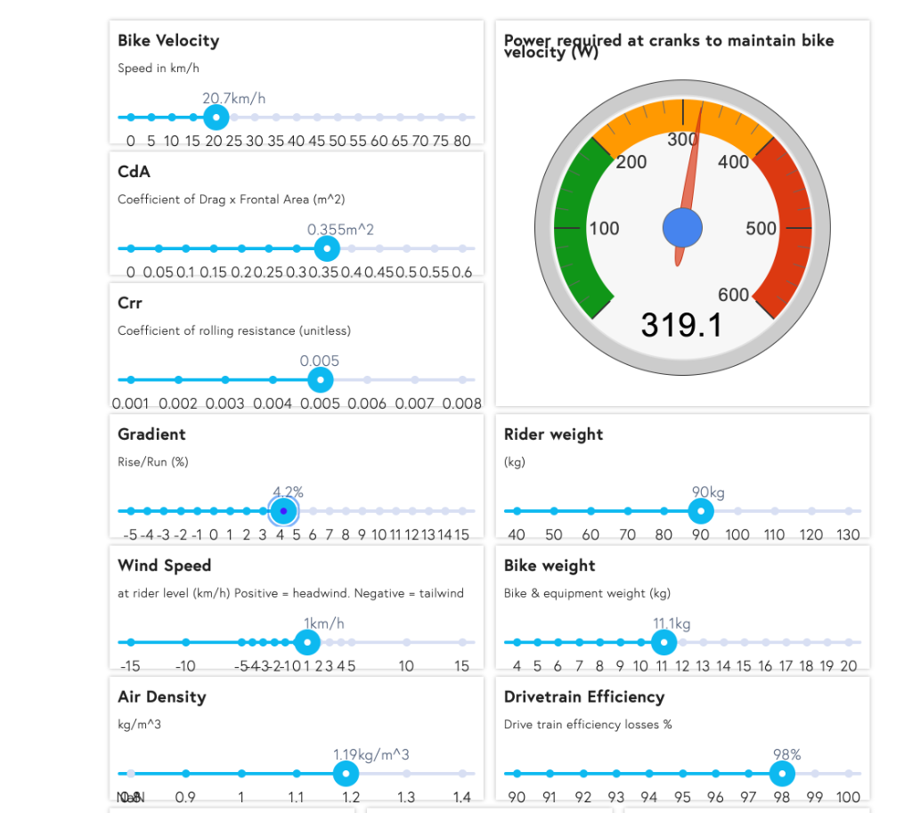

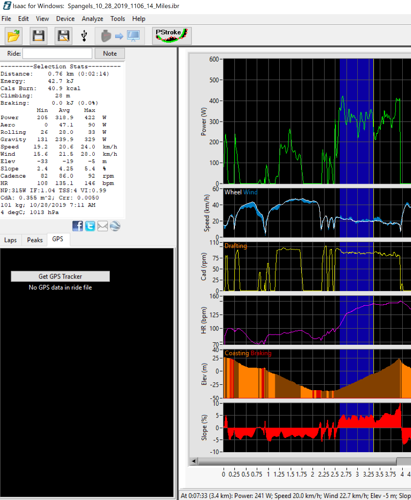

This is a nice test and the principles behind your reference website are sound.
I often use this website to check PowerPod measurements:
I like this site because it also incorporates the effects of headwind/tailwind wind speed and CdA.
Just for fun I took your first hill climb and plugged your measured numbers into the website I use.
PowerPod: 318.9W
AeroCoach: 319.1W
That is VERY close!!
One thing to be aware of when using these sites: the sites assume that your riding conditions are not changing. This means constant slope, wind speed, and bike speed. I picked only a section of your ride, where slope was nearly constant. You did a very nice job of holding bike speed constant, which improved the accuracy of the site's calculations.
PowerPod: 318.9W
AeroCoach: 319.1W
