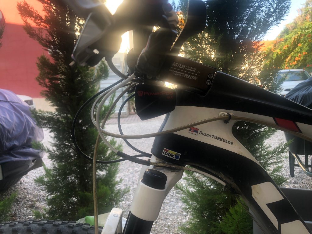

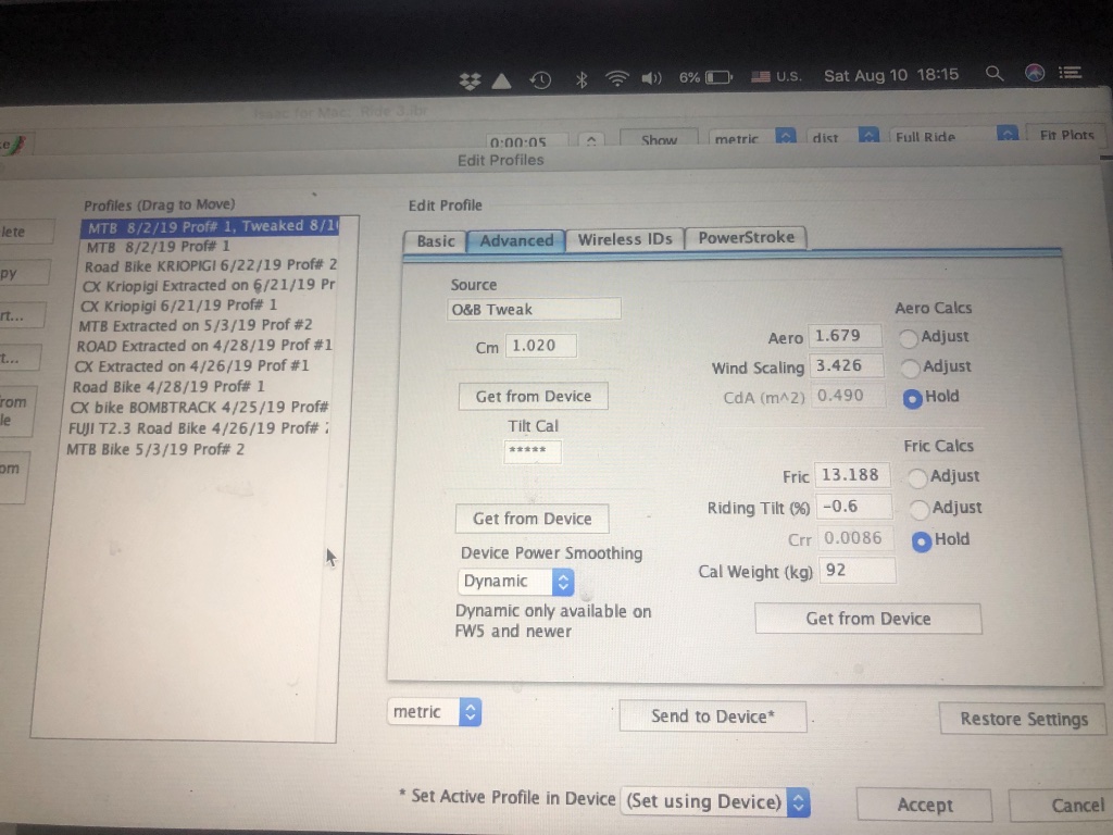

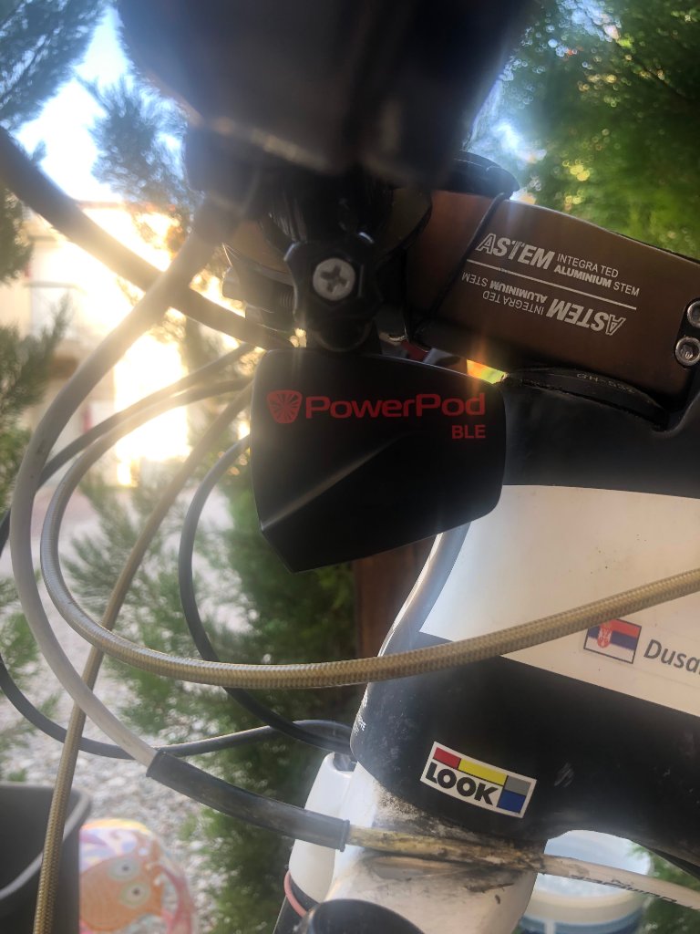

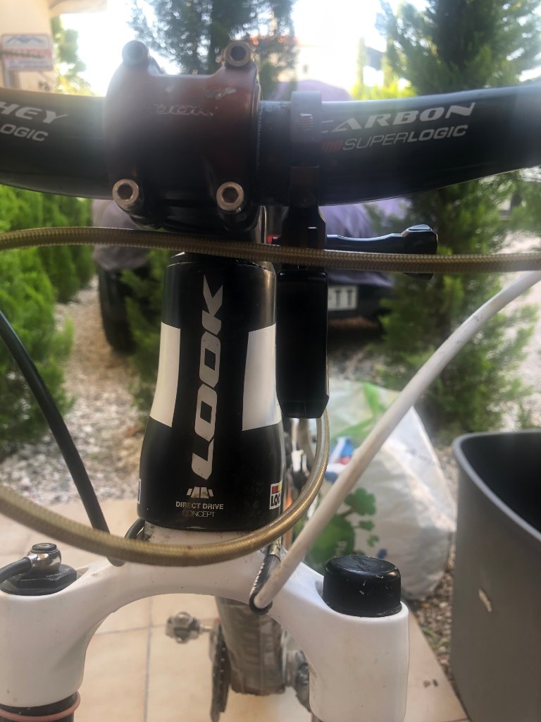

Ok, but there is two files. Should I upload Dusan.ibp or DusanRide3corr.ibr ?
There is pictures, tell me what I must correct.
I finished O&B ride and PP started measuring. What I should do next time I have 3 bike and want use for all of this PP

I uploaded ibp in my profile settings it seems that everything is uploaded. There is all sensors record an the rider weight, bike weight ....but now is different Aero , fric etc....I also uploaded ride 3 and this ride looking like a my usually ride. Tomorrow I will try on the ride. Next step should be my Cyclo Cross bike and Road bike ...

The letters on the PP are horizontal. is that all right?
Re: MTB measuring problems. Why is measurement not accurate?
Yes, the horizontal orientation of your PP looks good.Dusan Turkulov wrote: ↑Sat Aug 10, 2019 12:55 pm The letters on the PP are horizontal. is that all right?
